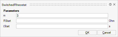

Switched rheostat, used for starting induction motors with slipring rotor:
The external rotor resistance RStart is shortened at time tStart.
mo_RStart | RStart | Starting resistance | Scalar | |
mo_tStart | tStart | Duration of switching on the starting resistor | Scalar |
plug_p | implicit | To positive rotor plug | input | 1 |
plug_n | implicit | To negative rotor plug | output | 1 |
