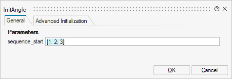

Compute three rotational angles angle for a given rotational sequence sequence_start from a relative orientation from frame_a to frame_b.
mo_sequence_start | sequence_start | Sequence of angle rotations | Vector of size 3 |

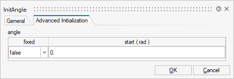

mo_angle/fixed | fixed | Cell of vectors of size 3 | true | |
mo_angle/start | start | Cell of vectors of size 3 |
