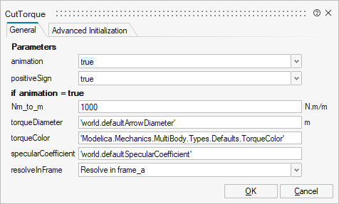

mo_animation | animation | = true, if animation shall be enabled (show arrow) | Scalar | true |
mo_positiveSign | positiveSign | = true, if torque with positive sign is returned (= frame_a.t), otherwise with negative sign (= frame_b.t) | Scalar | true |
mo_Nm_to_m | Nm_to_m | Torque arrow scaling (length = torque/Nm_to_m) | Scalar | |
mo_torqueDiameter | torqueDiameter | Diameter of torque arrow | Scalar | |
mo_torqueColor | torqueColor | Color of torque arrow | Vector of size 3 | |
mo_specularCoefficient | specularCoefficient | Reflection of ambient light (= 0: light is completely absorbed) | Scalar | |
mo_resolveInFrame | resolveInFrame | Frame in which output vector(s) is/are resolved (world, frame_a, or frame_resolve) | Structure | |

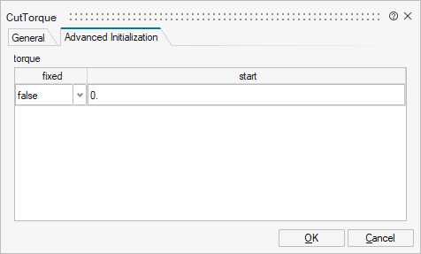

mo_torque | torque | torque | Structure | |
mo_torque/fixed | fixed | Cell of vectors of size 3 | true | |
mo_torque/start | start | Cell of vectors of size 3 |
