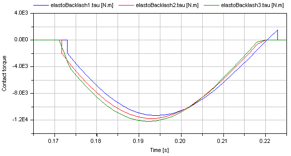

In the next figure, a typical simulation with the ElastoBacklash model is shown (Examples.Backlash) where the different effects are visualized:
- Curve 1 (elastoBacklash1.tau) is the unmodified contact torque, i.e., the linear spring/damper characteristic. A pulling/sticking torque is present at the end of the contact.
 - Curve 2 (elastoBacklash2.tau) is the contact torque, where the torque is explicitly set to zero when pulling/sticking occurs. The contact torque is discontinuous at begin of contact.
 - Curve 3 (elastoBacklash3.tau) is the ElastoBacklash model of this library. No discontinuity and no pulling/sticking occurs.

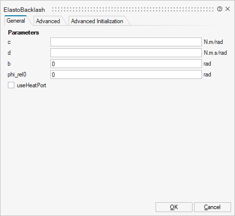

mo_c  | c  | Spring constant (c > 0 required)  | Scalar  | |
mo_d  | d  | Damping constant  | Scalar  | |
mo_b  | b  | Total backlash  | Scalar  | |
mo_phi_rel0  | phi_rel0  | Unstretched spring angle  | Scalar  | |
mo_useHeatPort  | useHeatPort  | =true, if heatPort is enabled  | Number  | 0  |

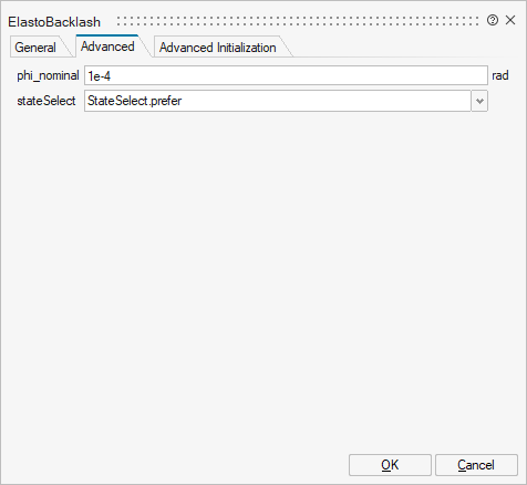

mo_phi_nominal  | phi_nominal  | Nominal value of phi_rel (used for scaling)  | Scalar  | |
mo_stateSelect  | stateSelect  | Priority to use phi_rel and w_rel as states  | Structure  | |
mo_stateSelect/choice1  | StateSelect.never  | Number  | 0  | |
mo_stateSelect/choice2  | StateSelect.avoid  | Number  | 0  | |
mo_stateSelect/choice3  | StateSelect.default  | Number  | 0  | |
mo_stateSelect/choice4  | StateSelect.prefer  | Number  | 0  | |

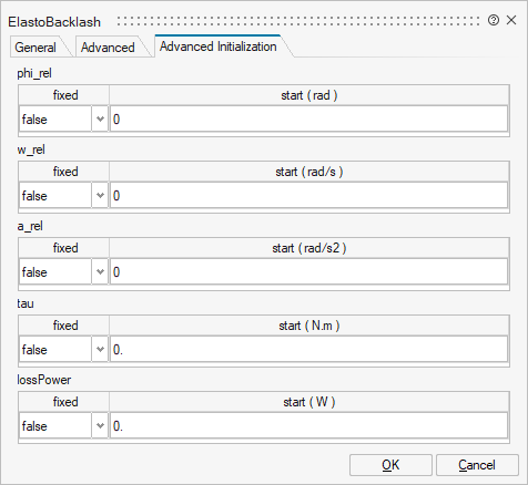

mo_stateSelect/choice5  | StateSelect.always  | Number  | 0  |
mo_phi_rel  | phi_rel  | phi_rel  | Structure  | |
mo_phi_rel/fixed  | fixed  | Cell of scalars  | true  | |
mo_phi_rel/start  | start  | Cell of scalars  | ||
mo_w_rel  | w_rel  | w_rel  | Structure  | |
mo_w_rel/fixed  | fixed  | Cell of scalars  | true  | |
mo_w_rel/start  | start  | Cell of scalars  | ||
mo_a_rel  | a_rel  | a_rel  | Structure  | |
mo_a_rel/fixed  | fixed  | Cell of scalars  | true  | |
mo_a_rel/start  | start  | Cell of scalars  | ||
mo_tau  | tau  | tau  | Structure  | |
mo_tau/fixed  | fixed  | Cell of scalars  | true  | |
mo_tau/start  | start  | Cell of scalars  | ||
mo_lossPower  | lossPower  | lossPower  | Structure  | |
mo_lossPower/fixed  | fixed  | Cell of scalars  | true  | |
mo_lossPower/start  | start  | Cell of scalars  |
