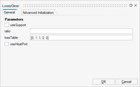

mo_useSupport | useSupport | = true, if support flange enabled, otherwise implicitly grounded | Number | 0 |
mo_ratio | ratio | Transmission ratio (flange_a.phi/flange_b.phi) | Scalar | |
mo_lossTable | lossTable | Array for mesh efficiencies and bearing friction depending on speed | Matrix of size Mx5 | |

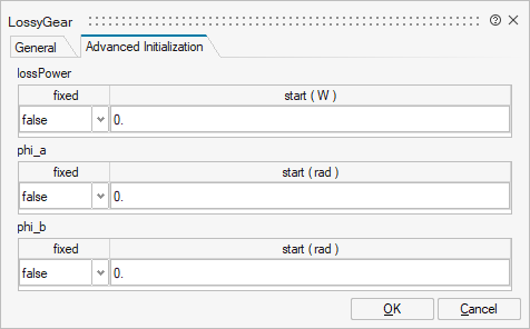

mo_lossPower | lossPower | lossPower | Structure | |
mo_lossPower/fixed | fixed | Cell of scalars | true | |
mo_lossPower/start | start | Cell of scalars | ||
mo_phi_a | phi_a | phi_a | Structure | |
mo_phi_a/fixed | fixed | Cell of scalars | true | |
mo_phi_a/start | start | Cell of scalars | ||
mo_phi_b | phi_b | phi_b | Structure | |
mo_phi_b/fixed | fixed | Cell of scalars | true | |
mo_phi_b/start | start | Cell of scalars | ||

flange_a | implicit | Flange of left shaft | input | 1 |
flange_b | implicit | Flange of right shaft | output | 1 |
Port 3 | implicit | Support/housing of component | input | mo_useSupport |
Port 4 | implicit | Optional port to which dissipated losses are transported in form of heat | input | mo_useHeatPort |
