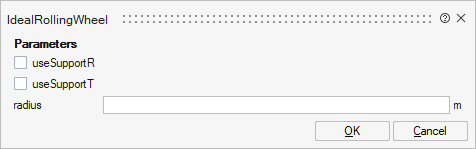

mo_useSupportR | useSupportR | = true, if rotational support flange enabled, otherwise implicitly grounded | Number | 0 |
mo_useSupportT | useSupportT | = true, if translational support flange enabled, otherwise implicitly grounded | Number | 0 |
mo_radius | radius | Wheel radius | Scalar |
