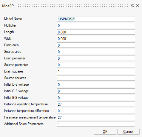

sp_mname  | Model Name  | Name of the Mos model  | String  | |
sp_m  | Multiplier  | Multiplier for setting m mosfets in parallel  | Scalar  | |
sp_l  | Length  | Channel length (meter)  | Scalar  | |
sp_w  | Width  | Channel width (meter)  | Scalar  | |
sp_ad  | Drain area  | Drain area (square meter)  | Scalar  | |
sp_as  | Source area  | Source area (square meter)  | Scalar  | |
sp_pd  | Drain perimeter  | Drain perimeter (square meter)  | Scalar  | |
sp_ps  | Source perimeter  | Source perimeter (square meter)  | Scalar  | |
sp_nrd  | Drain squares  | Equivalent number of squares of the drain diffusion  | Scalar  | |
sp_nrs  | Source squares  | Equivalent number of squares of the source diffusion  | Scalar  | |
sp_icvds  | Initial D-S voltage  | Initial drain source voltage (volts)  | Scalar  | |
sp_icvgs  | Initial G-S voltage  | Initial gate source voltage (volts)  | Scalar  | |
sp_icvbs  | Initial B-S voltage  | Initial bulk source voltage (volts)  | Scalar  | |
sp_temp  | Instance operating temperature  | The temperature at which the mosfet is operating (degrees Celsius)  | Scalar  | |
sp_dtemp  | Instance temperature difference  | Temperature variation relative to the simulation temperature (degrees Celsius)  | Scalar  | |
sp_tnom  | Parameter measurement temperature  | Scalar  | ||
sp_Spice  | Additional Spice Parameters  | For more details, see the section   | String  |
