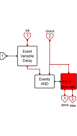

This block generates an event when the time period set at initialization and provided by the regular input runs out. This block generates an activation signal via its second output activation port. This signal is the redirection of the input activation of the block when crossing does not occur.
done
activation
The check activation is redirected to this output if the timeout period is over.
output
1
else
activation
The check activation is redirected to this output if the timeout period is not over.
output
2
init
activation
This event starts the timer (timeout period).
input
1
check
activation
Check activation.
input
2
Port 5
explicit
input
1
Diagram
ContTimerEx2
