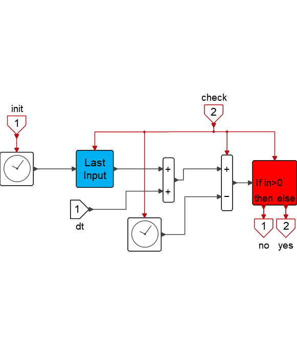

TimerEx2
Timer block.
    TimerEx2
StateMachine
In this block, an event on the init activation port starts the timer. An event on its check activation port is then directed to the yes output if the specified time-period, called timeout, is over. It i otherwise redirected to the no output. So, the event on the check port checks if the timeout period has run out or not.
no
activation
The check activation is redirected to this output if the timeout period is not over.
output
1
yes
activation
The check activation is redirected to this output if the timeout period is over.
output
2
init
activation
This event starts the timer (timeout period).
input
1
check
activation
Check activation.
input
2
dt
explicit
input
1
Diagram
TimerEx2
