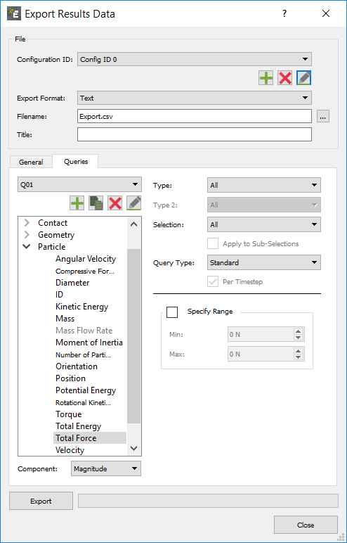

Export Data - Creating a Query
A configuration can contain multiple queries, each of which defines one data attribute. Queries define what information is exported.
- Click the Queries tab and click the + icon to create a new query.
The attributes that can be exported are listed under the element they relate to (collisions, contacts, particles, or geometry).
- Click any attribute to select it and then select the component of that attribute.
For example, the magnitude of a contact vector. All available attributes and their components are listed in the following tables. - Select the Geometry section or type of particle or contact for which you want to export data.
For example, select only collisions between certain particle types, or the force on a particular geometry section. Data can be extracted on all elements of the selected type (or geometry section) or it can be limited to just those contained within a particular bin group or selection group. - To extract data on all elements, use the Selection dropdown where all the bin and selection groups that have been created are listed.
- Select the Apply to Sub-Selections checkbox to export a separate query for each bin in a group (if defined), rather than one combined query for the entire group.

To specify a value range for the data exported, select the Specify Range checkbox to limit the export to data that falls between two specified values. For example, only exporting particle velocity data for particles traveling between 3m/s and 5m/s.

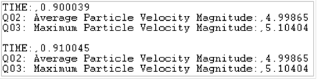

Similarly, you can create further queries. Once all the queries have been set up, click Export to export your data to your specified file. For more information on attributes, see Appendix A: Attribute Definitions.
- Queries are ordered using the natural sort order where strings are ordered alphabetically except multi-digit numbers which are ordered as a single character.

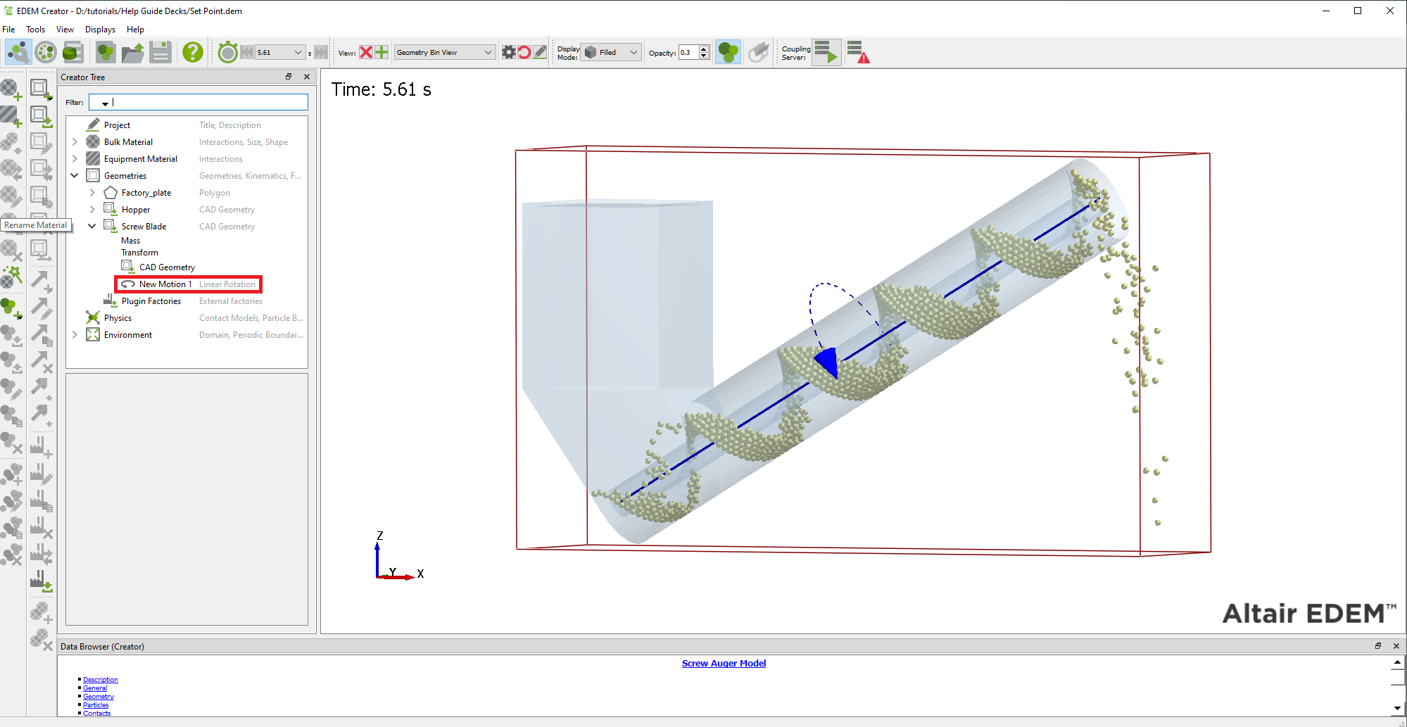

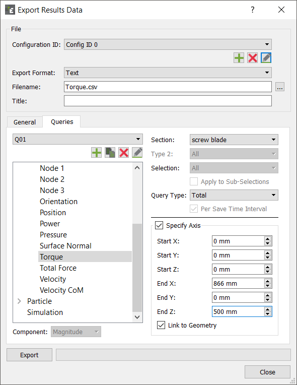

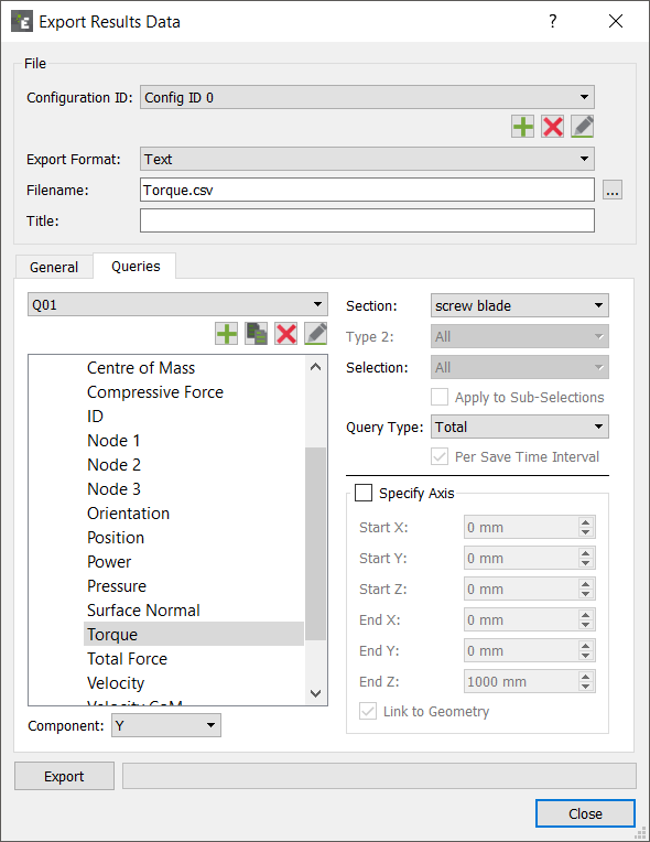

Torque query standard, average, maximum, or minimum will provide the torque values based on the individual triangular elements. The torque Specify Axis option is recommended or alternatively the torque Total via a specific axis.
Torque Query Type Total Component X, Y or Z for a named geometry component (for example, a screw blade) will provide a resulting torque values along the X,Y or Z axis for the geometry component through the geometry Center of Mass.
The torque Specify Axis allows you to determine which axis the torque is exported around, especially useful for geometry that is not aligned along the X,Y or Z axis or if the Center of Mass is not known. The following example shows the auger with a specified rotation.
Following is the recommended torque export.
The torque is exported along the user-defined axis which matches the axis of rotation of the auger.

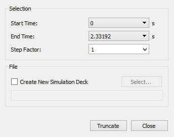

Truncating Results
Used to remove results data (time steps) from your simulation. Data can be removed entirely, or simply 'thinned out' by removing every nth result.
- Select File > Truncate File.
- In the Truncate File dialog box, specify the Start Time and End Time.
This defines the Time steps between which you would like to remove data. - Set the Step Factor by selecting a factor from the list or specify a new value.
This determines how often a Time Step in the range is removed. If the step factor is set to one, every Time Step will be retained. If it is set to greater than one, the data in the range will effectively be 'thinned out'. The greater the step factor, the more data is removed.
By default, the selected data will be truncated from the current simulation deck. - Select the Create New EDEM Simulation Deck checkbox to truncate to a new simulation deck.
The original deck is unaffected.
