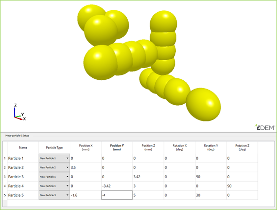

    In the empty dialog box, right-click and select Add Particle. Repeat to add the required number of particles for the desired Meta-Particle.
  2. In the Particle Type dropdown, select the particles that will make up the desired Meta-Particle.
    1. To add, remove, or copy a particle from the setup, use the following icons:  , , .
    2. Use any combination of different particles to form Meta-Particles (this is not restricted to the same Bulk Material).
    3. Use any arrangement that allows bonding upon creation.
  3. Arrange the particles using the X, Y, and Z positioning and rotation coordinates so that the particles are next to each other with minimal overlap or separation.
    1. If the particles are significantly overlapping, they will repel and break apart when the Meta-Particle is created.
    2. If the particles are spaced too far apart, they will not bond with each other during the creation process and the Meta-Particle will not form correctly.
The icon highlights the particle that is currently being edited, and the active particle is highlighted in red in the table.
