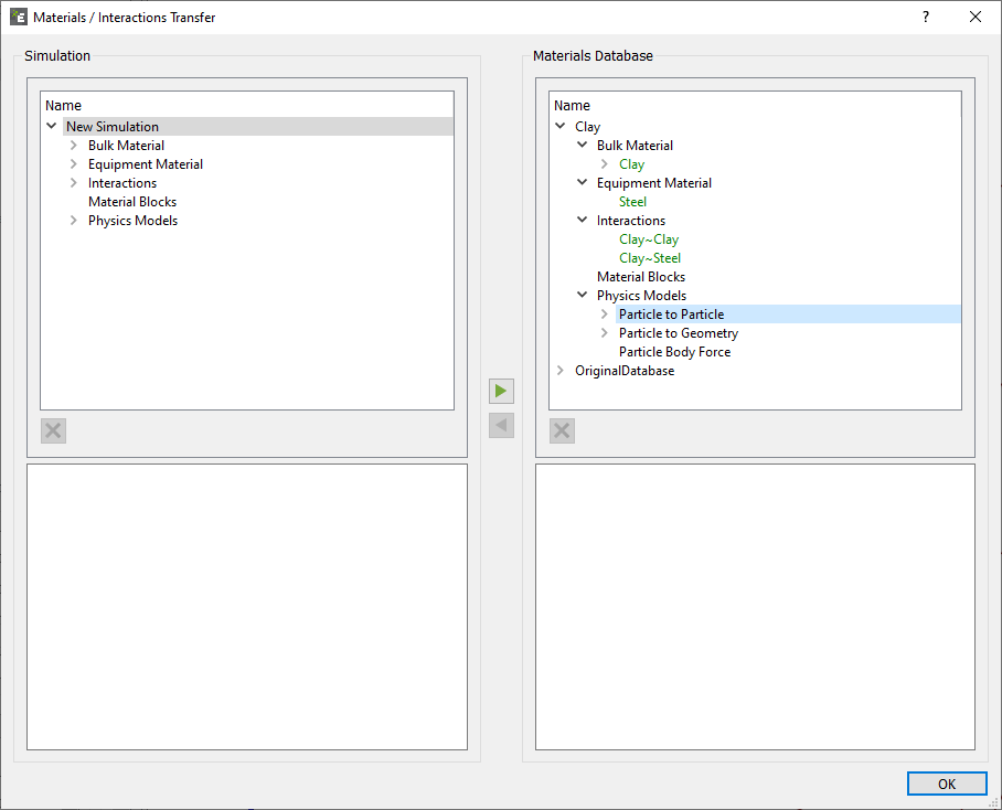

  1. In the Bulk Material tab, right-click and select Transfer Material.
  2. In the Transfer dialog box, click the material to transfer.
    The material's properties are displayed.
  3. Click the appropriate arrow to transfer the material to or from the database.
  • If a material in the model and database have the same name but different properties, they are highlighted in red to indicate the conflict.
  • If you continue with the transfer, one material will overwrite the other.
  • If two materials have the same name and the same properties they are both highlighted in green.
  • If a Meta-Particle is in the simulation which matches the Meta-Particle name, but is a different particle definition in the database it will be highlighted in red.
  • If there is a mismatch with particle properties of the particles used to construct the Meta-Particle, they will be highlighted in yellow.
  • Equipment Materials will automatically be assigned to the Equipment Material section and Bulk Materials will automatically be assigned to the Bulk Material section of the Creator Tree.
  • However, the interaction information has to be transferred separately.
