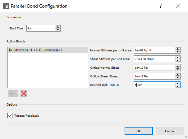

Interaction Configurable Parameters Position
Particle to Particle     Select an active bond then set the Bond Formation Time and the following parameters:
Normal Stiffness: the tensile/compressive stiffness along the bond’s principal axis.
Shear Stiffness: Shear stiffness in the orthogonal plane to the bond’s principal axis.
Critical Normal Stress: the maximum normal stress the bond can withstand before it fails.
Critical Shear Stress: The maximum tangential stress the bond can withstand before it fails.
Bonded Disk Radius: The radius of the cylindrical bond between the particles.
Torque Feedback: Enables the Bond Torque to be returned to the Particle.
Set the bond stress and stiffness values to represent the material that is been modeled. A high stiffness value will produce high bond forces and stresses. A lower than normal Time Step may be required to accurately capture these high forces.
When the Bond Formation Time is reached, all defined particles in contact will be bonded together. Before this time, particles interact based on the Hertz-Mindlin contact model.

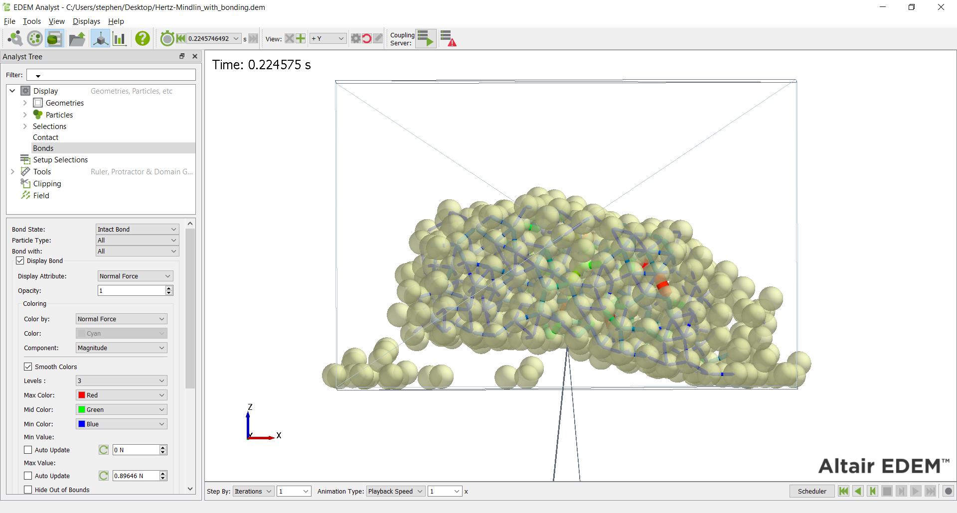

Bonds can be post-processed in the EDEM Analyst under Bond information.
The Bonded V2 model uses Custom Contacts and the post-processing uses Contact information in the Analyst.
