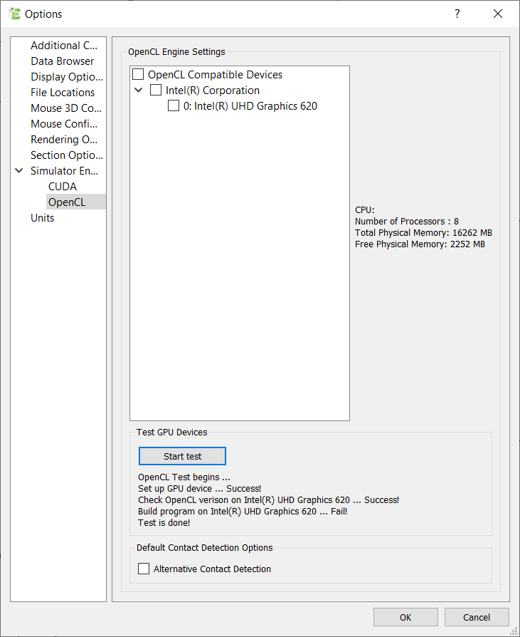

If EDEM displays any error message related to OpenCL, try updating to the latest driver first. GPU card manufacturers are regularly updating drivers to fix bugs so make sure you’re on the latest driver and check regularly.
The test is a standard hardware test for GPU. If the test fails, ensure that  your Graphics Card drivers are up to date and try again or contact support with details of the GPU device used.
The GPU option will be accessible from the Selected Engine dropdown only after the test has run successfully.
