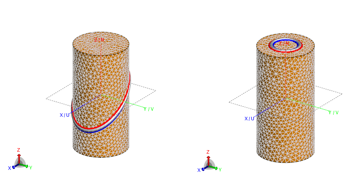

Figure 3. An edge port is added to the thick dipole. Note the edge closes
on itself.

Figure 4. Examples of valid edge ports on a triangular mesh.

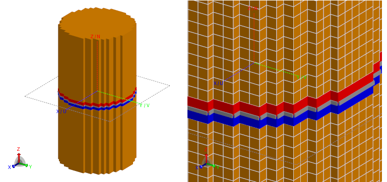

Figure 5. A valid edge port on a voxel mesh. Note the meshed port faces all lie in
the same plane.

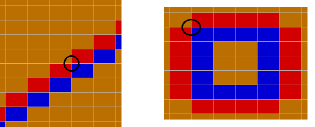

Figure 6. If a voxel mesh is applied to the same model as the top example and a
similar edge port is specified, it results in an invalid edge port as
displayed in the section views. The black circles indicate an example of a
point with conflicting potentials.
