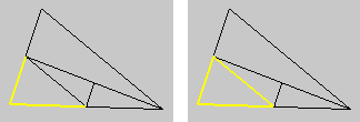

Figure 1. Example 1 showing two selected wires. Using the Select edge loop tool results in the smallest loop containing these edges being selected. Note that the background colour was changed to show the selection (indicated in yellow) more clearly.

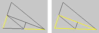

Figure 2. Example 2 showing two selected wires. Using the Select edge loop tool results in the smallest loop containing these edges being selected.
