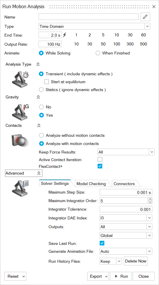

Basic Settings
Use the options on the Run Motion Analysis window to define a motion analysis.
Figure 1. Run Motion Analysis- Name
- Enter a name for the Motion analysis run.

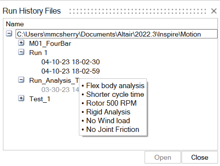

- Description
- Click
to enter a description for the analysis. The description
appears as a tooltip when you hover over corresponding Run History files in the Plot
Manager. - Type
- Select Time Domain to run a motion analysis with respect to time, or Eigen Analysis to run an eigenmode analysis.
- End Time
- The end time indicates how long the motion simulation should run. To add 10% more time, while holding down the Ctrl key, click Calculate End Time. This is handy for seeing model behavior after the profile has ended.
- Output Rate
- The output rate controls the number of frames in the results output. Larger numbers give smoother, continuous results, but will animate more slowly.
- Animate
- This option controls whether the model animates While Solving. If you select When Finished, the run will complete faster. If the run is successful, you still have the ability play back the animation by pressing the space bar or clicking the Play button on the animation toolbar.
- Analysis Type (appears for Time Domain only)
- A motion analysis can be either transient, static, or both.
- Transient analysis is used to include dynamic effects in a time-dependent motion simulation. Enable Start at equilibrium to begin from an equilibrium solution first.
- Statics analysis is used to determine the static equilibrium position of your mechanism. For this analysis type, all velocity and damping terms are ignored. This helps you analyze the loading without including dynamic effects.
- Operating Point (appears for Eigen Analysis only)
- The operating point is the position and orientation of the system at which the Eigen analysis should be conducted. See Eigen Analysis Settings for additional information.
- Gravity
- This setting is used to include or exclude gravity from the motion analysis. To include gravity, you must first apply gravitational acceleration using the Gravity tool.
- Contacts
- Analyze without motion contacts: Choose this option to exclude motion contacts from the motion analysis.
- Analyze with motion contacts: Choose this option to include motion contacts from the motion analysis.
Keep Force Results is a global setting to control the number of contact forces that are stored in the model after motion analysis. Choose All, Region Only or None.
The Region Only option corresponds to the At Region setting for Sum Forces on the Force Explorer. If you choose Region Only or None, be aware that when animating motion results with the Force Explorer, you will only see the level of content you specified for a given contact. For example, if you choose Region Only you will not see the individual (unsummed) force vectors. Likewise, you would not see any of the force vectors due to contact if you select None.

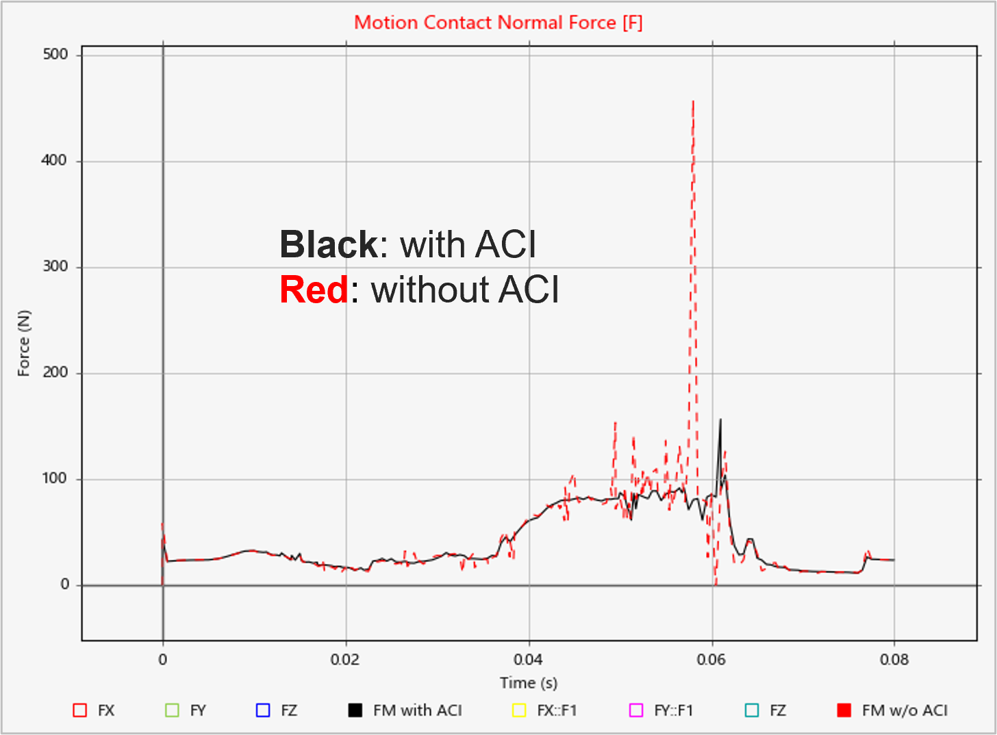

Note: If you want to override the global setting for Keep Force Results and treat a motion contact individually, you can do so from the Property Editor. - Active Contact Iteration: In certain models that involve
contact between parts, the quality of the force results can depend on the
frequency of updating the matrix of partial derivatives of the solution (Jacobian
matrix). In models where there may be a large time step or a high contact
stiffness relative to contact damping, the contact forces may appear noisy.
Turn on ACI to update the Jacobian matrix with every output step, thereby helping the solution converge with smoother results. ACI performs additional refinement to the solution for contact events, helping to reduce noise due to contact forces and provide more accurate force results overall.
Depending on the application type, ACI may improve speed or accuracy or both. You may obtain more accurate results and experience shorter run times in certain contact models. However, in some models, using ACI may also increase the simulation time slightly.
By default, ACI is turned on in models created in version 2022 and later, and it is turned off in models created earlier than version 2022.
- FlexContact+: When using flexible bodies in a motion contact, consider stress or strain at the contact interface by performing a more comprehensive and predictive analysis. You can model contacts between rigid/flexible and flexible/flexible parts.
