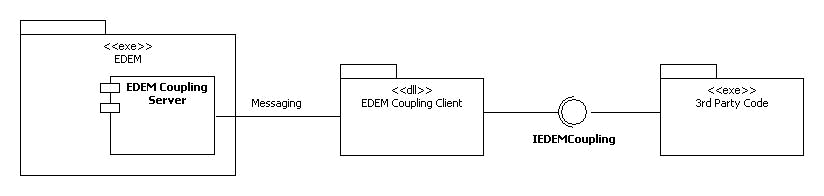

The EDEM Coupling Interface comprises client and server components. The server component resides within EDEM and the client component is to be used by the 3rd party code to interact with EDEM. The EDEM Coupling Client interface class provides users with a number of methods for setup, simulation and data control.
Overview of the packaging of the EDEM Coupling Interface:

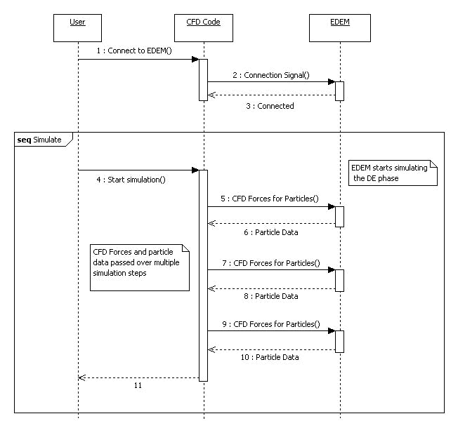

The sequence of a coupled simulation is shown below, with the CFD Coupling Interface relaying information on CFD forces and particle data between the two solvers.
Once a coupling is successfully initialized between EDEM and the CFD solver, EDEM is ready to start simulating (Steps 1-3). Simulation in EDEM will commence when the CFD solver sends fluid forces to apply to the particles in the simulation (Steps 5, 7, 9). If this is the first step of a simulation, and there are no particles to apply forces to, then this can be omitted before starting the EDEM simulation-step.
The coupled simulation sequence:

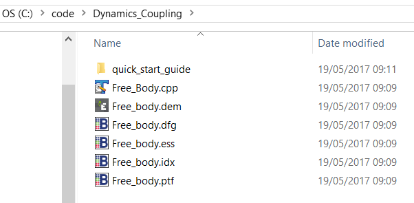

Place the .cpp files written by the user in a working directory, e.g. C:\code\Dynamics_Coupling. In this instance a Free_Body.cpp file is used which can be found on the EDEM Forum.

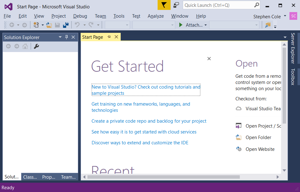

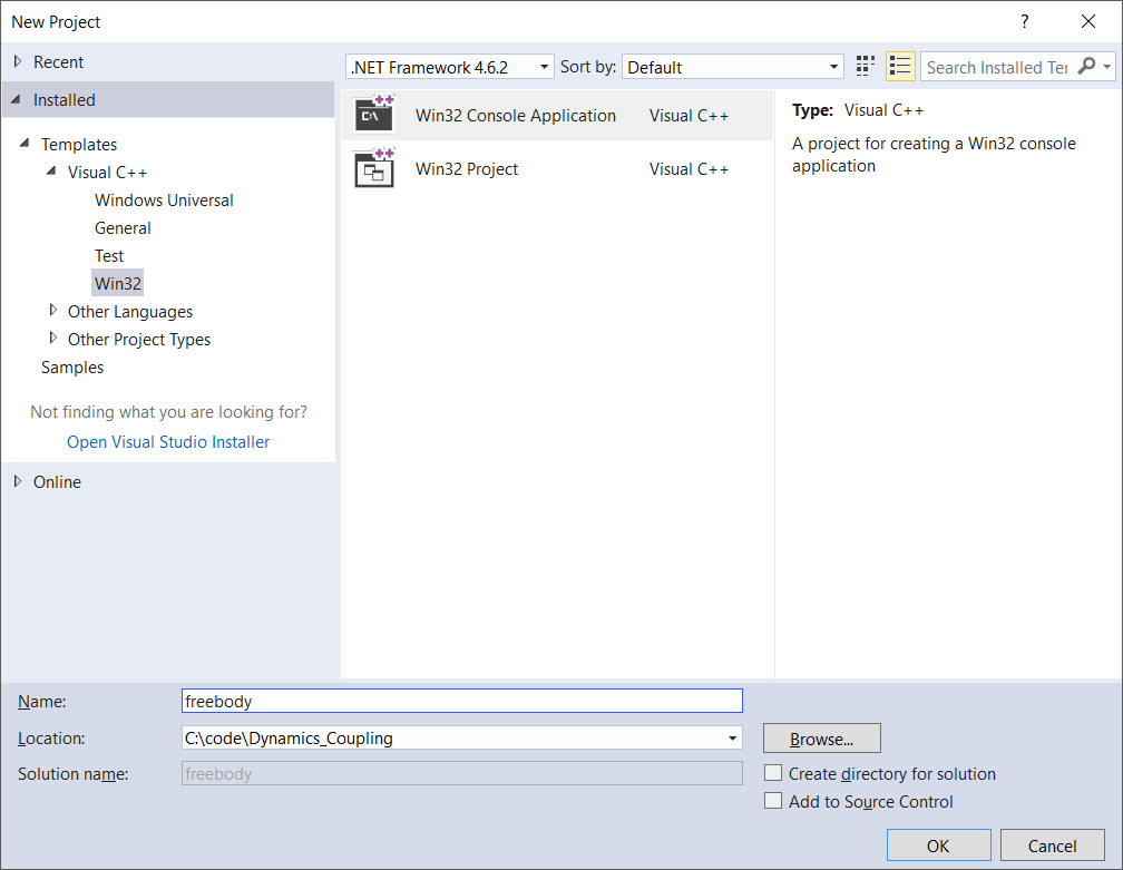

Start Visual Studio
Create a New Project (Win32 Console Application Visual C++)
Go to File > New > Project
Set name: freebody
Set location C:\code\Dynamics Coupling
Choose OK

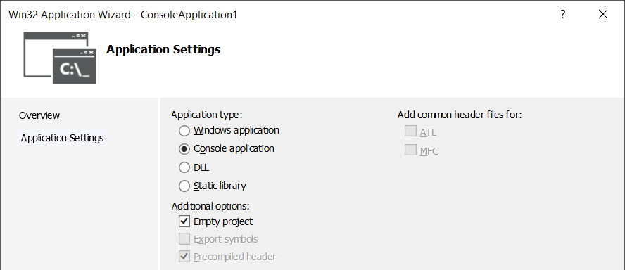

Select Application Settings
Choose Console Application
Select Empty Project
Click Finish

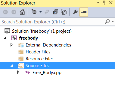

Add the file Free_Body.cpp to the project
Copy this file to C:\code\Dynamics_Coupling\freebody
Right Click on Source Files > Add > Existing Item > Free_Body.cpp > Add

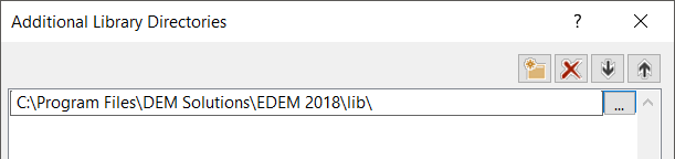

Select Configuration Properties > Linker > General > Additional Library Directories > edit
Include:
C:\Program Files\Altair\2022\EDEM\bin\lib\
