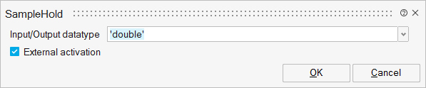

typ | Input/Output datatype | Specifies the data type of the input and output. | String | 'double' |
externalActivation | External activation | Specifies whether the block receives an external activation or inherits its activation through its regular input ports. When External Activation is selected, an additional activation port is added to the block. By default, external activation is selected. | Number | 0 |
