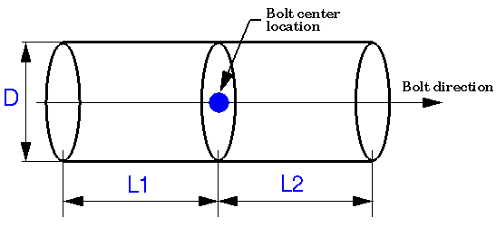

The secondary nodes of the rigid body(ies) are searched in the cylinder defined below:
All the nodes of the selected parts (set 1 and set 2) inside the cylinder will be added to the bolt.
