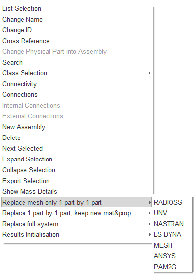

| 1. | In the Tree window, select the part to be replaced. |
| 2. | Open the context menu (right-click mouse button) and select Replace mesh only 1 part by 1 part and select the input format: |
Alternatively, you can use replace 1 part by 1 part, keep new mat&prop to replace parts but keep the current materials and properties instead of using the ones for the imported (replacement) part.

| 1. | In the Tree window, select the parts and/or assemblies to be replaced. |
| 2. | Open the context menu (right mouse button), select Replace full system, and select the input format: |
