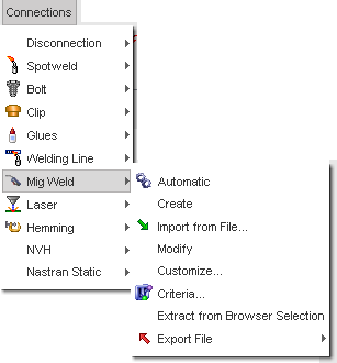

Automatic creation
All the uncreated Mig welds can be created automatically:
| • | Open the Connections > Mig Weld > Automatic. |
Manual creation
| • | Select Mig Weld > Create. |
