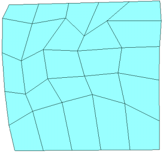

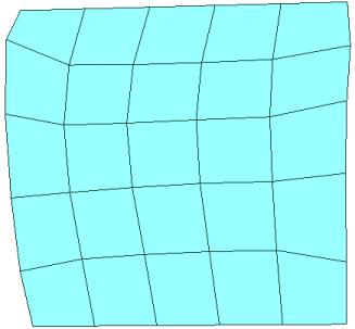

The following is an example of a mesh before and after smoothing:
Before Smoothing |
Preview After Smoothing |
