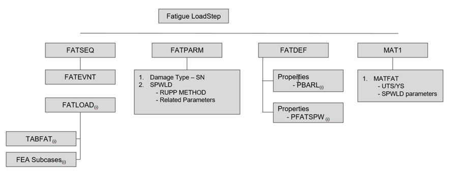

Define TABFAT Load Collector
Define FATLOAD Load Collector
Create a fatload each for the loadcases present.

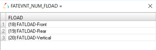

Define FATEVNT Load Collector
Create an event to assign the fatloads created.
Define FATSEQ Load Collector
Define Fatigue Parameters
Define Fatigue Material Properties
The material curve for the fatigue analysis can be defined on the MAT1 card.
