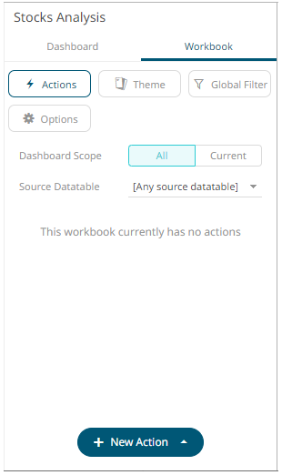

1. On the Dashboard and Workbook Settings pane, click the Workbook tab.
The Actions pane is displayed. Initially, there are no actions defined for the workbook and the selected Dashboard Scope is All.
