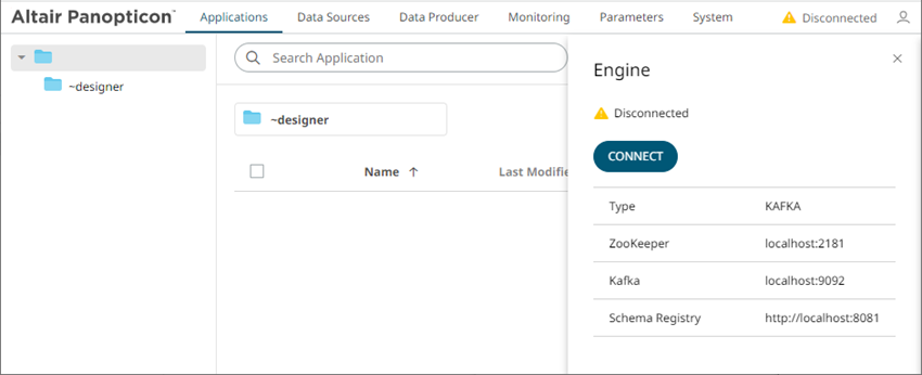

Connecting to or Disconnecting from the CEP Engine
Click Kafka Connection Status to expand and display the Engine panel and view the settings.
For
For
Property |
Description |
Status |
Displays whether Panopticon Streams is connected to or disconnected from the CEP Engine (Kafka). |
Type |
The CEP Engine that Panopticon Streams engine will work with (KAFKA). |
ZooKeeper |
The URL to the ZooKeeper servers. Default is localhost:2181. |
Kafka |
The URL of all the Kafka servers. Default is localhost:9092. |
Schema Registry |
The URL to the Schema Registry. Default is http://localhost:8081. |
