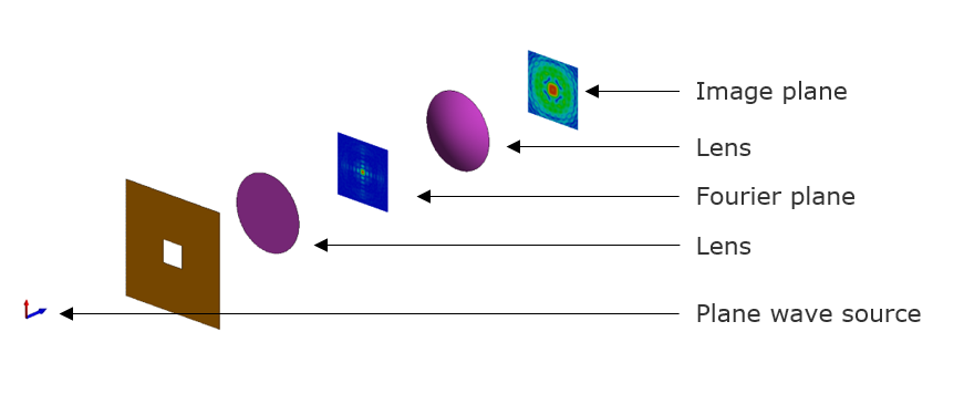

- Extended GPU support for RL-GO including computations with dielectric materials,
including dielectric sheets and coatings.Figure 1. The optical 4F correlator (dielectric lenses) in the image simulates 16 times faster in Feko 2019 than in Feko 2018.2.1 on a laptop with Nvidia Quadro M1000M GPU.

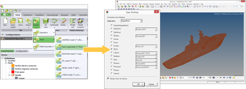

- Improved interaction between HyperMesh and Feko. A new Feko user profile in HyperMesh
2019 supports efficient mesh generation and material assignments for Feko in HyperMesh.
Full bidirectional transfer of mesh and material data between Feko and HyperMesh is
supported.Figure 3. The Feko User Profile in HyperMesh ensures the generation of a valid mesh for Feko.
