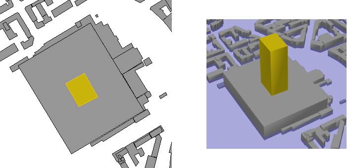

Figure 1. Top view of the courtyard (on the left) and 3D view (to the right). The Fill Objects display setting was disabled for demonstrative purposes. - Tower: The height of the tower is greater than the height of the standard
building that contains it.

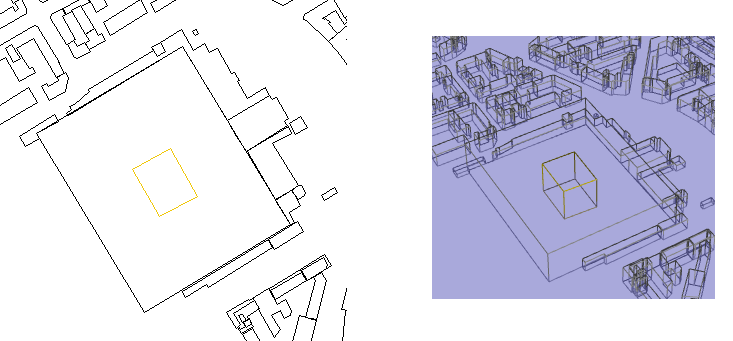

Figure 2. Top view of the tower (on the left) and 3D view (to the right).
