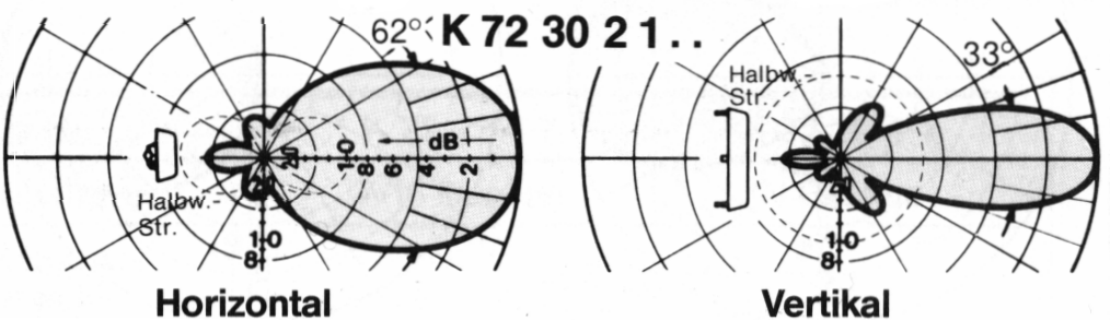

Figure 1. K7230211 antenna as given in Kathrein catalog.

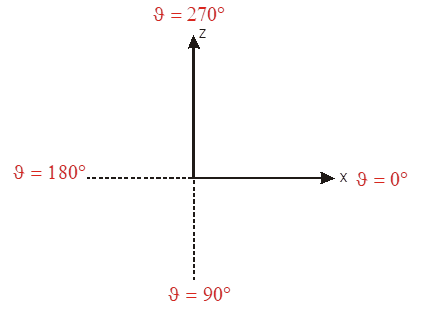

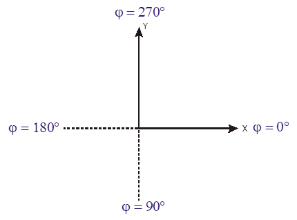

The 2D antenna pattern is the graphical representation of the directional characteristic in a 2D plane. A polar diagram is used to describe the antenna pattern. While the vertical pattern results from , the horizontal pattern is formed from .
