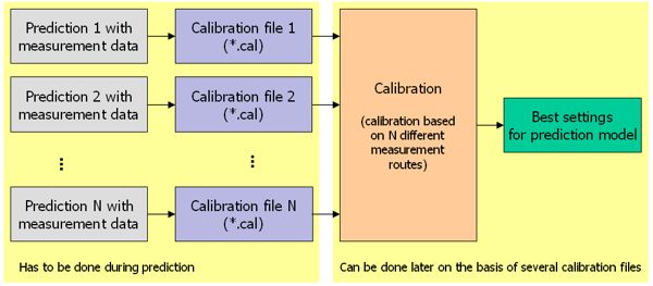

Some propagation models support the calibration of material properties and of clutter/land usage databases. The following diagram shows the basic procedure for the calibration of the propagation models.
Figure 1. Procedure for the calibration of propagation models.

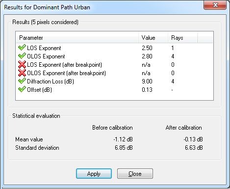

Figure 5. The Results for Dominant Path Urban dialog.
The statistical evaluation gives information about mean value and standard deviation from measurements to predictions before and after the calibration. Depending on the optimization method different results can be obtained.
