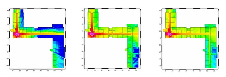

Ray-optical propagation models are still time-consuming – even with accelerations like preprocessing. And what is even more important, they rely on an accurate vector database. Small errors in the database influence the accuracy of the prediction. On the other hand, empirical models are rely on dedicated propagation effects like the over-rooftop propagation (for example the direct ray COST 231). A comparison of prediction results computed with three types of prediction models is presented in the following figure:
Figure 1. Prediction results with three types of prediction models. Empirical COST 231 (on the left), intelligent ray-tracing (in the middle) and indoor dominant path (to the right).

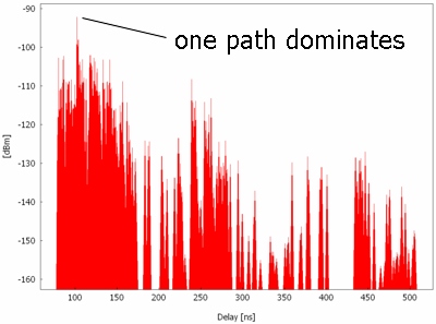

Analyzing typical propagation scenarios shows that in most cases one propagation path contributes more than 90% of the total energy. The dominant path model (DPM) determines exactly this dominant path between the transmitter and each receiver pixel. So the computation time compared to ray-tracing is significantly reduced and the accuracy is nearly identical to ray-tracing.
Figure 2. A typical channel impulse response where one path dominates.

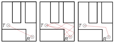

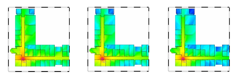

Empirical models (like COST 231) consider only the direct path between a transmitter and a receiver pixel. Ray tracing models (like IRT) determine numerous paths. DPM determines only the most relevant path, which leads to short computation times.
Figure 3. Comparison of different approaches (COST 231 on the left, ray-tracing in the middle and DPM to the right).

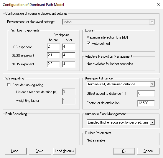

Figure 4. The Configuration of Dominant Path Model dialog.
- Path Loss Exponents
- The path loss exponents influence the propagation result computed by the DPM significantly. The path loss exponents describe the attenuation with distance. A higher path loss exponent leads to a higher attenuation in same distance.
- Losses
- Each change in the direction of propagation due to an interaction (diffraction, transmission/penetration) along a propagation path causes an additional attenuation. The maximum attenuation can be defined. The effective interaction loss depends on the angle of the diffraction. It is recommended to select Auto. The transmitter frequency will then be taken into account in the calculation of maximum interaction loss.
- Waveguiding effects
- As mentioned before, the DPM includes waveguiding effects to achieve accurate results. Two parameters are available to configure the wave guiding module. The first parameter is used to define the maximum distance to walls to be included in the determination of the wave guiding factor. With the second parameter the weight of the wave guiding effects in the computation of the path loss is defined (1.0 is suggested. Values below 1.0 reduce the influence of the wave guiding factor and values above 1.0 increase it). In typical scenarios the wave guiding effects can be turned off, this reduces the prediction time.
- Breakpoint distance
- The breakpoint distance describes the distance from the transmitter when destructive superposition of the direct ray and the ground reflected ray occurs. Because of that the attenuation is much higher and thus larger path loss exponents are often used. The default distance for the breakpoint distance in indoor environments is 500m.
