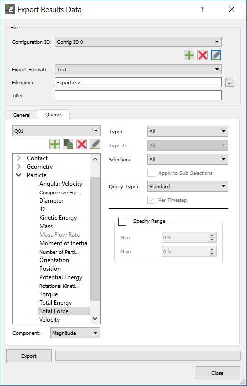

Export data using the Export Data Dialog (File > Export > Results Data).
Queries define what information is exported. A configuration can contain multiple queries, each of which defines one data attribute.
The Query Tab:
Click on the Queries tab and click the + button to create a new query. The attributes that can be exported are listed under the element they relate to (collisions, contacts, particles or geometry). Click on any attribute to select it and then select the component of that attribute you are in interested in: for example the magnitude of a contact vector. All available attributes and their components are listed in the tables below.
Next choose the geometry section or type of particle or contact you want to export data for: for example choose only collisions between certain particle types, or the force on a particular geometry section.
Data can be extracted on all elements of the selected type (or geometry section) or it can be limited to just those contained within a particular bin group or selection group. This can be selected using the Selection drop-down list where all bin and selection groups that have been created are listed. Enable the Apply to Sub-Selections checkbox to export a separate query for each bin in a group (if defined), rather than one combined query for the entire group.

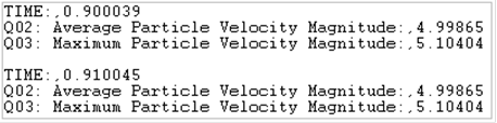

The Query Type option is used to determine which data values will be exported for a particular attribute: For example, if the query has been set up to export the velocity of particles of type A you could choose to export the maximum, minimum or average velocity per time step. The following data is exported for each query type:
The final option is Specify Range. This is used to specify a value range for the data exported. In other words, limiting the export to data that falls between two specified values. For example, only exporting particle velocity data for particles traveling between 3m/s and 5m/s.
Further queries can be created in the same way. Once all queries have been set up, click the Export button to export your data to your specified file. Refer to Appendix A: Attribute Definitions for more information on attributes.

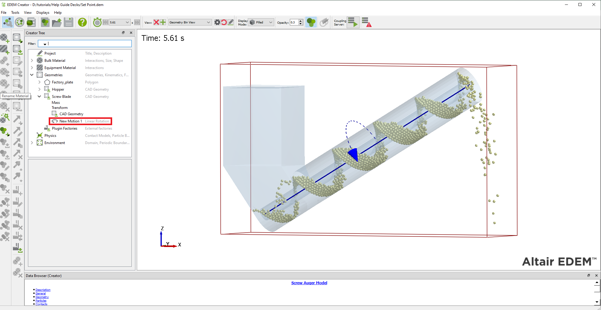

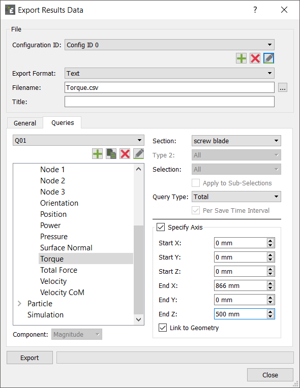

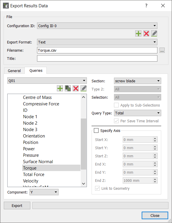

Torque query standard, average, maximum or minimum will provide the torque values based on the individual triangular elements. The torque Specify Axis option is recommended or alternatively the torque Total via a specific axis:
Torque Query Type Total Component X, Y or Z for a named geometry component (e.g. screw blade) will provide a resulting torque values along the X,Y or Z axis for the geometry component through the geometry Center of Mass.
The torque Specify Axis allows the user to determine which axis the torque is exported around, especially useful for geometry that is not aligned along the X,Y or Z axis or if the Center of Mass is not known. For example the auger in the image below has a rotation specified as shown:
The recommended torque export is therefore the following:
The torque is exported along the user defined axis which matches the axis of rotation of the auger.

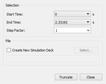

The Truncate option is used to remove results data (time steps) from your simulation. Data can be removed entirely, or simply 'thinned out' by removing every nth result.
Select File > Truncate File. The Truncate file dialog is displayed:
Set the Start and End Times. This defines the times steps between which you would like to remove data. Only full time steps can be truncated: you cannot truncate time steps from partial saves.
Set the Step Factor. A factor can be selected from the list or a new value entered directly. This determines how often a time step in the range is removed. If the step factor is set to one, every time step will be retained. If it is set to greater than one, the data in the range will effectively be 'thinned out'. The greater the step factor, the more data is removed.
By default the selected data will be truncated from the current simulation deck. Tick Create New EDEM Simulation Deck to truncate to a new simulation deck. The original deck is unaffected.
