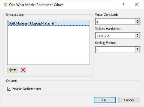

To use this model in EDEM requires the additional input of the material’s Vickers hardness, Hv (GPa), the material’s Wear Constant, WOka. EDEM also offers the option to deform the geometry according to the quantitative results given by the impact wear model. If the Enable Deformation option is selected another input parameter, Scaling Factor, is presented which allows the deformation results to be scaled as desired.
Interaction | Configurable Parameters | Position |
Particle to Geometry | Assign a Wear Constant, Vickers Hardness value for each Equipment Material-Particle interaction and Scaling Factor (if Deformation enabled). | Last |
To enable geometry deformation select the “Enable Deformation” option in the parameter values GUI shown below. Please note that geometry deformation is currently only available on the CPU.
