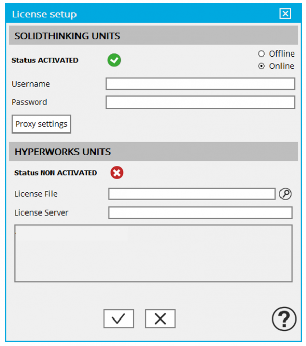

5. solidThinking units license activation
Prerequisites: You must first activate your solidThinking portal account and download the software. If your company uses a proxy server, you will also need the host and port numbers.
1) Launch the software. If you do not have a valid license on your workstation, the License Setup window will open automatically, and the license status will show as Not Activated.
| License setup Settings - Dialog box |
2) Enter the Username and Password you created for your solidThinking portal account

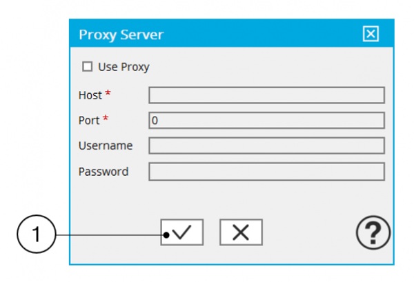

3) If your company uses a proxy server, click Proxy Settings, select Use Proxy, and enter the Host and Port numbers
| Proxy Server Settings - Dialog box |
4) If your proxy server requires authentication, click Proxy Server Login and enter a Username and Password
5) Click on the apply button (Mark 1 - Previous figure: Proxy Server Settings - Dialog box). The status will change to Activated when the license is validated, or you will receive an error message if unsuccessful

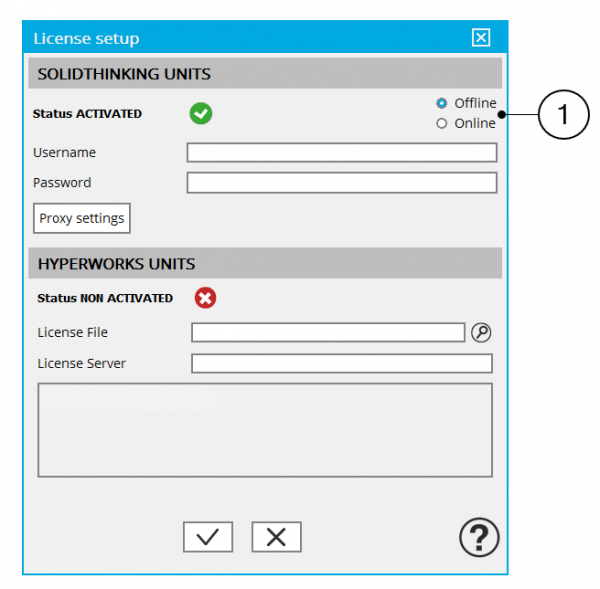

6. Using solidThinking unit license in offline
solidThinking units can be checked out and used in offline mode for up to two weeks. Each application must be checked out individually.
2) Select File > Licensing to open the License Setup window
| License setup Settings - Dialog box MODE Online |
3) Click the Offline Mode slider. You may now run the application without an internet connection for up to two weeks. Note that each application must be checked out individually
| Figure 13 – License setup Settings - Dialog box – Mode Offline |
4) To check the units back in, click the Online Mode check box again
