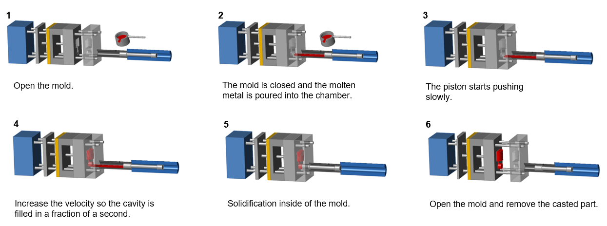

High pressure die casting uses a machine to inject molten metal into permanent metal dies under high pressure. It is a good technique for manufacturing complex parts with a high degree of accuracy, particularly lightweight parts with thin walls that require consistent dimensions. The high pressure is needed to fill the mold completely and avoid solidification during the casting process.
High pressure die casting uses two distinct velocities. The molten metal is first pushed at a low velocity (initial velocity) in order to avoid turbulence and the formation of bubbles. Just before the material enters the mold, the velocity increases (second phase velocity), and the molten metal is injected very quickly into the die assembly to fill it completely.

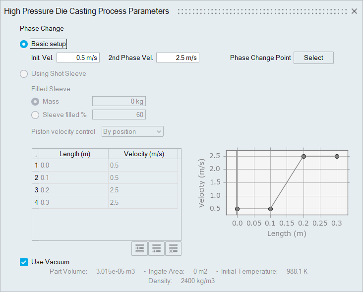

- Basic setup
- This option will be selected when no shot sleeve is included in the model.
- Initial Velocity (m/s)
- Typical values for Initial Velocity are 0.2–0.5 m/s.
- Second Phase Velocity (m/s)
- Typical values for Second Phase Velocity are 2.0–5.0 m/s.

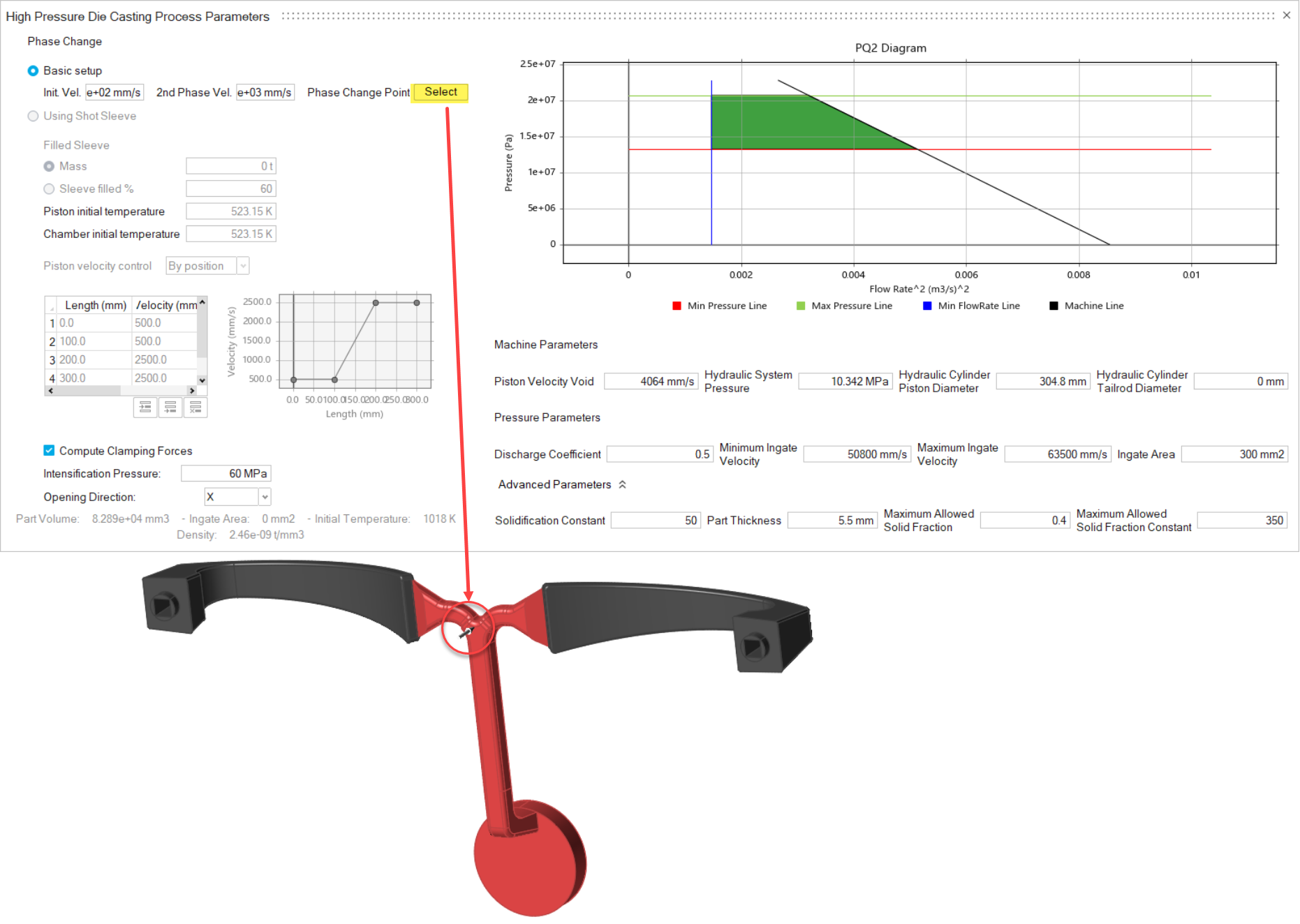

- Phase Change Point
- To specify where the initial velocity changes to the second
phase velocity, click Select, and
then click a point on the runner.Tip: The phase change point needs to be on the runner, before the material enters the mold.

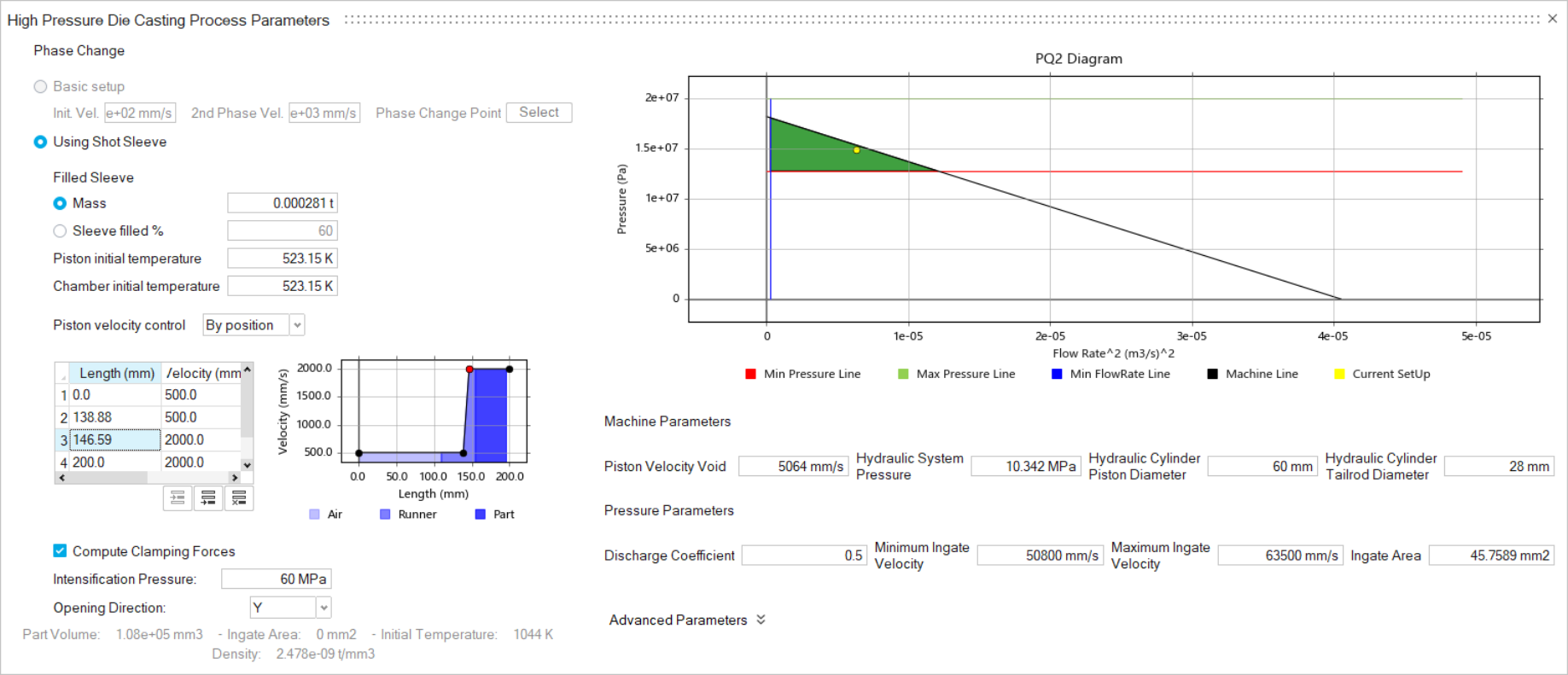

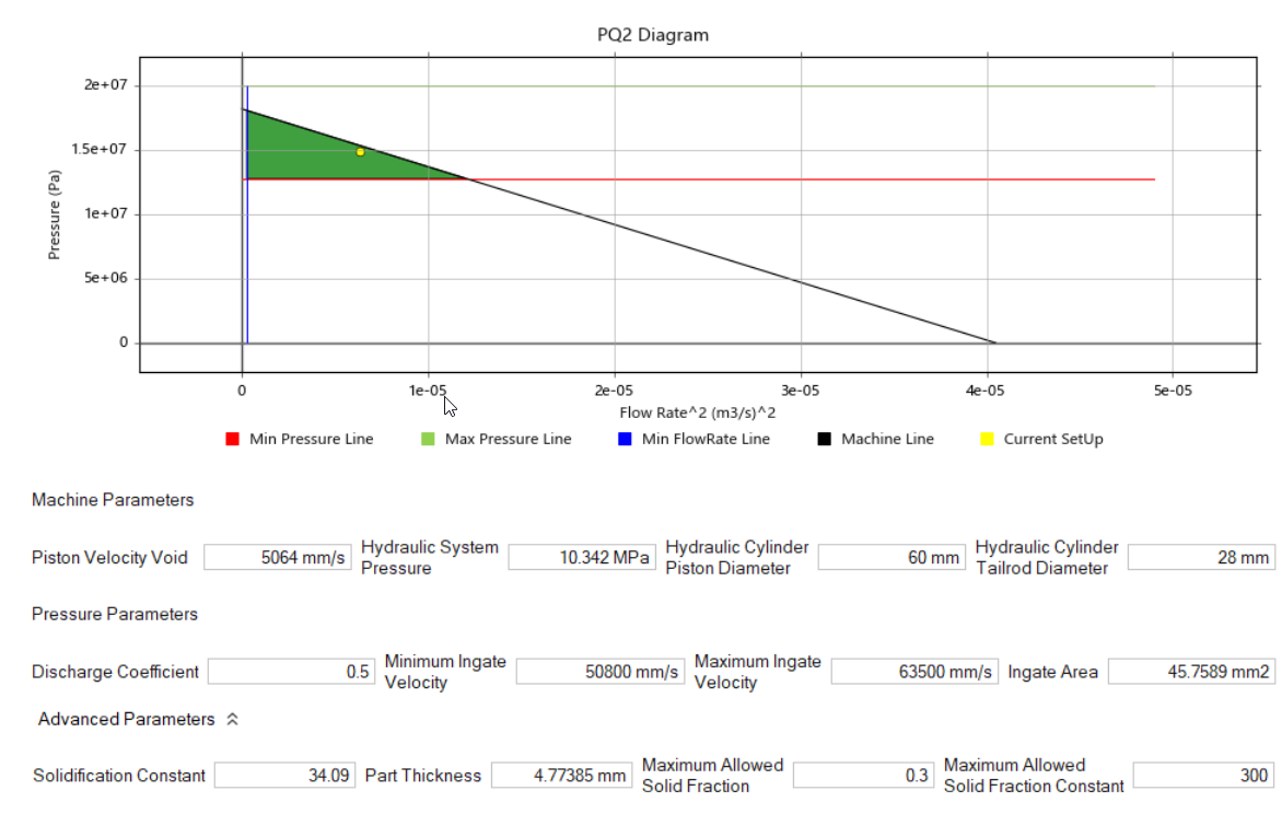

- PQ2 Diagram
- This tool can help you improve the machine setup in the
high-pressure die casting process. The diagram shows a green
safety region on a pressure vs flow rate graph. The safety
area is defined by the minimum and maximum pressure and
minimum and maximum flow rate during the casting process.
Note: The PQ2 diagram and its parameters are useful only when the model includes a shot sleeve.
The yellow Current Setup point in the diagram shows the current machine setup based on the settings in the Piston Velocity and Ingate Area fields.
- Compute Clamping Forces
- Enable this option to have the solver calculate the force necessary to keep the mold closed during casting. Clamping force is the product of the separation force for the mold and a user-editable safety factor. View the result and edit the safety factor in the Analysis Explorer.
- Intensification Pressure
- This is the maximum pressure applied during the casting process. The value defaults to 600 Kg/cm2 (or 60 MPa). This field is editable when Compute Clamping Forces is enabled.
