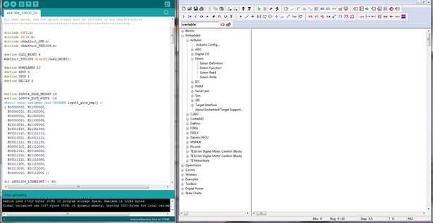

7.    Start Embed and position it next to the Arduino window.

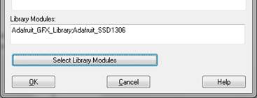

11.  Click Select Library Modules.
12.  In the External Library Selection dialog box, select Adafruit_SSD1306 and Adafruit_GFX_Library, then click OK.
13.  The Extern Definition dialog box displays the selected libraries under Library Modules.

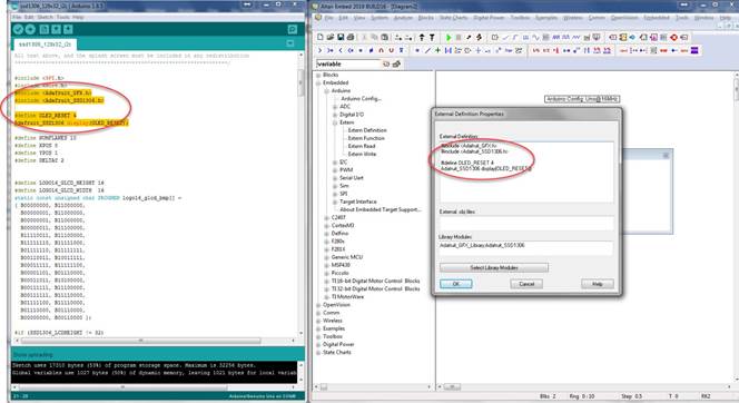

14.  With the Arduino window and Embed window side-by-side, copy the #include, #define, and instantiation declarations from the Arduino sketch into the External Definition window.
ArduinoExample2 ArduionEmbedsidebyside windowsAdd code to ExternDefinition db
15.  In the Extern Definition window, rename the Adafruit_GFX.h and Adafruit_SSD1306.h to Adafruit_GFX.cpp and Adafruit_SSD1306.cpp. The CPP files contain all the driver logic.

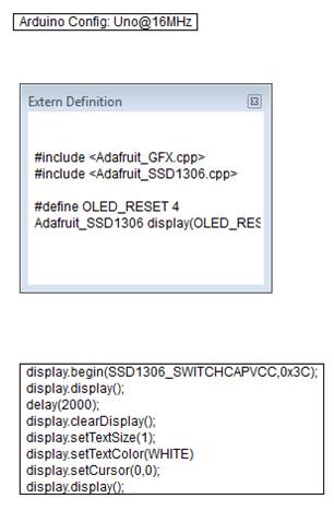

17.  Integrate a setup loop into the diagram using the Extern Function block.
a.    Insert an Extern Function block into the diagram beneath the Extern Definition block.
b.    In the Arduino sketch, copy the following code into the Extern Function block under Function Name:
display.begin(SSD1306_SWITCHCAPVCC, 0x3C);
display.display();
delay(2000);
display.clearDisplay();
display.setTextSize(1);
display.setTextColor(WHITE);
display.setCursor(0,0);
display.display();
Your diagram will look like this:

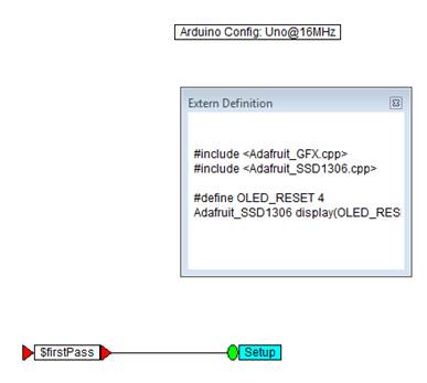

c.     Encapsulate the Extern Function block in a compound block and name it Setup.
d.    CTRL-right-click over Setup and in the dialog box, activate Enabled Execution and click OK.
A screenshot of a cell phone
Description automatically generated
e.    Wire a variable block into Setup and set the variable block to $firstPass. Because Setup runs only once at boot, the $firstPass flag is used to control the enabled compound to run once at boot.

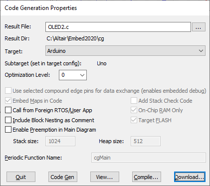

23.  To compile the code for the Arduino, click Tools > Code Gen.
24.  In the Code Generation Properties dialog box, click Compile.

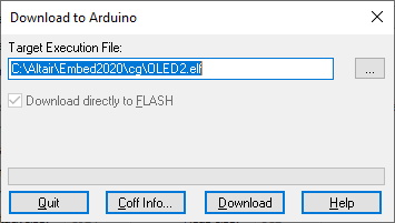

25.  The code is compiled in a DOS window. When the compilation completes, click Download in the Code Gen dialog box.
26.  In the Download to Arduino dialog box, click Download.
 The text Hello, world! is displayed on the SSD1306.
