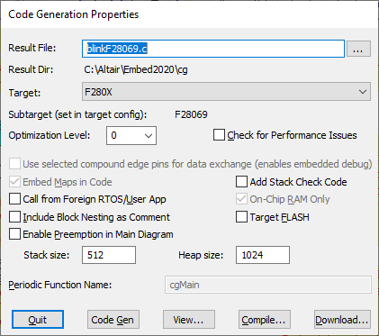

3.    Choose Tools > Code Gen.
4.    Do the following:
      Under Result File, check that the file name displayed is named currently-open-diagram-name.C.
      Under Result Dir, check that the directory is <Embed-install-directory>\cg. If it is not, click … to update the directory.
      Under Target, choose the platform you are targeting. By default, Embed uses the last target you specified for the diagram.
Under Subtarget, check that the selected CPU is correct. If it is incorrect, click Quit and update the Target Config block in the diagram. After you save the diagram and click on Tools > Code Gen, the subtarget will reflect your change.
5.    Choose the remaining code generation parameters.
6.    Click Compile. The following actions are performed:
      The integration algorithm is set to Runge Kutta 4th order if it was previously set to an algorithm more complex than Runge Kutta 4th order.
      A C file is generated. Blocks are translated either directly into one or more C operations or into one or more calls to the Embed C Support C support library. A small set of blocks are unsupported in Embed and are translated into function calls that produce EMPTY returns.
      The C compiler included with the Embed hardware kit is invoked to compile and link the C file, support libraries, and header files to create an OUT file, which is stored in the same location as the C file.
      An MS/DOS window is opened in which to view the code generation, compilation and linking phases.
7.    Click any key to exit the MS/DOS window.

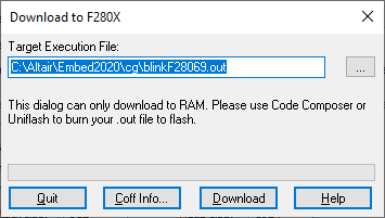

8.    Click Download in the Code Generation dialog box to start the process of downloading the OUT file to your embedded target. The following dialog box appears.
9.    Under Target Execution File, specify the OUT file to be downloaded, if it is not already set to the file path.
10.  Click Coff Info if you want to access information about the sizes of the various linker segments, including data, text, and initialization.
11.  Click Download to download the code to the target RAM.
