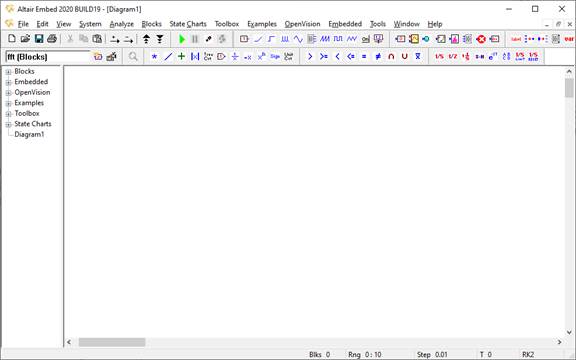

Start Embed.
An empty diagram appears named Diagram1.

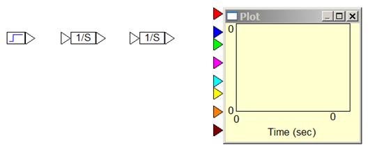

To construct the second-order system, you will use a step block, two integrator blocks, and a plot block.

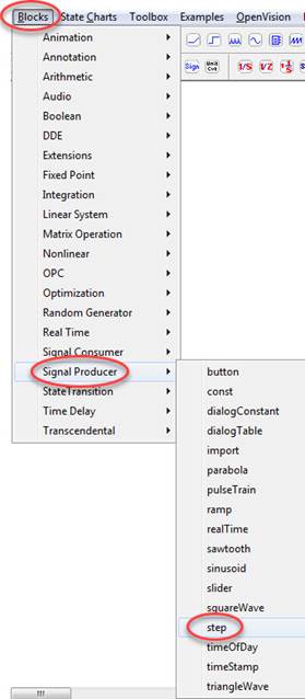

1. Choose Blocks > Signal Producer and click step.
2. The Blocks menu disappears, and the pointer appears with a marquee attached to it.
3. Move the pointer to the work area and click to add the step block.
4. Repeat these steps to add two integrator blocks and a plot block. The integrator block is under Blocks > Integration, and the plot block is under Blocks > Signal Consumer.

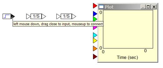

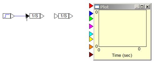

To make a connection
1. Point to the output tab on the step block. The pointer turns into an upward pointing arrow when it is over the tab.

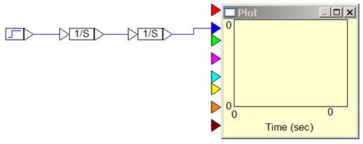

2. Drag the pointer to the input tab on the integrator block. When you release the mouse button, the connection is completed.

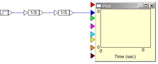

When all the connections are complete, the diagram looks like this:

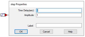

Most blocks have parameters that allow you to set attributes specific to the block.
To set block parameters
•Right-click the mouse over the step block to display the Properties dialog box.
For this example, no changes are required; however, it is worth noting that you can control the strength of the output signal and the time to delay before calculating the output signal. You can also create a block label that appears below the block when you activate View > Block Labels.

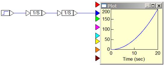

The diagram is now ready to be simulated. To start the simulation, choose System > Go.
The simulation runs until it reaches the specified end time. The plot block displays the simulation results for x2/2 from 0 to 20 sec.
