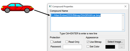

Blocks with associated files are referred to as VSMX-capable blocks. VSMX-capable blocks include animate, bezel, button, compound, dialogTable, embed, import, map, stateSpace, and transferFunction blocks. As shown below, a car image is applied to a compound block. The dialog box displays the path to the bitmap.
When you save this diagram with the VSM extension, the bitmap is not saved with the diagram; it remains in C:/Altair/Embed2020/Bitmap/DIAGRAM. However, when you save the diagram with the VSMX extension, Embed uses ZIP compression and saves the bitmap with the diagram.
