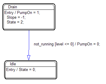

In the following example, a pump switches from a draining mode to idle mode based on the transition specification:
The trigger not-running causes the transition of the pump from ON to IDLE as long as the condition [level <=0] is TRUE.
