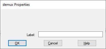

Block Category: Nonlinear
Inputs:
•sel: Integer
•val: Floating point, integer, scaled integer, or string
Description: The demux block presents the input value on the selected output connector. It can be used to demux a time division, multiplex data stream. To mux the data stream, use the case block.
