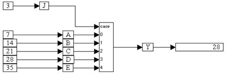

1. Implementation of five scalar branches
Consider the decision tree:
If J = 0, then Y = A;
else
If J = 1, then Y = B;
else
If J = 2, then Y = C;
else
If J = 3, then Y = D;
else
If J = 4, then Y = E;
If A, B, C, D, and E are assumed to be constant values equal to 7, 14, 21, 28, and 35 respectively, the decision tree is realized as:
Six const blocks produce values for the variable blocks named J, A, B, C, D, and E. The outputs of these variables are connected to a case block, with J connected to the case input, and variables A, B, C, D, and E connected to inputs 0, 1, 2, 3, and 4 respectively. The output of the case block is fed through a variable named Y and into a display block.
Since J is set to 3, the variable D is presented to the output as expected, and consequently, Y takes on the value of D, namely 28.

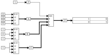

2. Implementation of three matrix branches
Consider the following part of the decision tree presented above:
else
else
If you let A, B, and C be:
case block equation example 2
Eight const blocks generate the elements of the three matrices, represented as three scalarToVector blocks. The variable J is set to 1 and is fed into the case input of a case block. The outputs of variables A, B, and C are wired to inputs 0, 1, and 2 of the case block. The output of the case block is connected to a variable Y, which is wired to a display block.
Since J is set to 1, the contents of variable B are presented at the output of the case block such that Y = B.

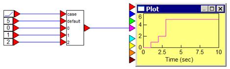

3. Implementation of three branches with a default value
case block example 2
In this implementation, there are case input connectors for 0 - 2, and an index in with a unit ramp signal. When the value of the case input reaches 3, the output value of the case block will be the value input on the default connector, which is 5.
