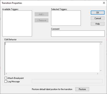

To define transition specifications
1.    Point and right-click over the transition between Init state and Fill state.
2.    The following Pop-Up menu appears:
3.    Click Properties.
The Transition Properties dialog box appears.
4.    Under Edit Behavior, enter the guard using the C language. Enclose the code in square brackets and terminate with a forward slash.
5.    Click OK.

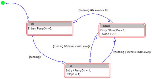

6.    Repeat these steps to add the following guards to the remaining transitions.
Transition
Guard
Fill to Drain
[ !running || level > = maxLevel]/
Drain to Init
[ !running && level <=0]/
Drain to Fill
[ running && level < minLevel]/
Your state chart will look like this:
