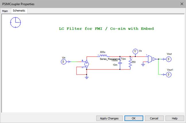

Edit Schematic: Invokes PSIM and opens the schematic in the Schematic tab.  Schematic tab. After editing the schematic, click Apply Changes in the Schematic window to add your changes to the schematic; then click OK to save the schematic.

Reload Schematic: Reloads the PSIM schematic with the latest changes. If you have made changes to the schematic after you opened it in Embed, you must click Apply Changes and OK in the Schematic window.
Window area: Displays the current PSIM schematic that is either to be linked to the Embed diagram or available for editing. In order to edit the schematic, you must click Edit Schematic in the Main tab.
Apply Changes: Applies the changes you made to the schematic. After you click OK, you can then click Reload Schematic in the Main tab to use the new schematic in the next co-simulation.
