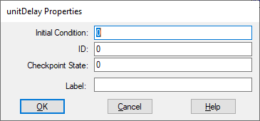

Checkpoint State: Contains the value of the unit delay at the checkpoint. If you have not checkpointed your simulation via the System > System Properties command, the value is 0. You can enter a value in hexadecimal notation or as a C expression.
ID: Reserved for future use.
Initial Condition: Sets an initial value for the output signal. The default is 0.
You can enter the initial value in scalar or vector notation. The initial condition matrix will set matrix dimensionality for the block. You can enter a value in hexadecimal notation or as a C expression.
