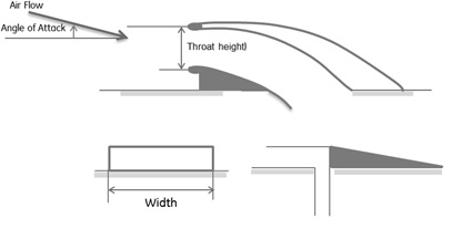

Typical Geometry inputs that are required to model Naca Inlets are provided in the below images
Flush Type:
Scoop type:

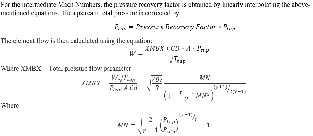

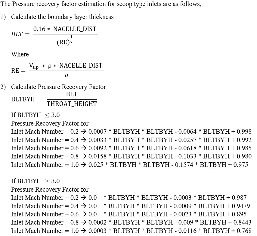

Scoop Type Inlets

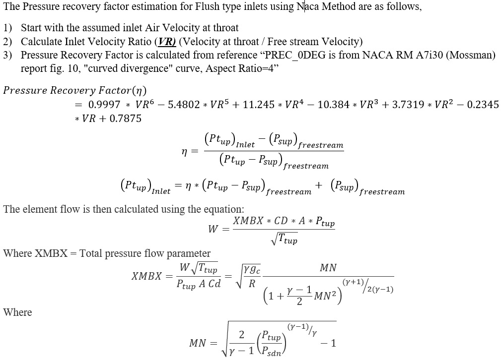

Flush Type Inlets (Naca Method)

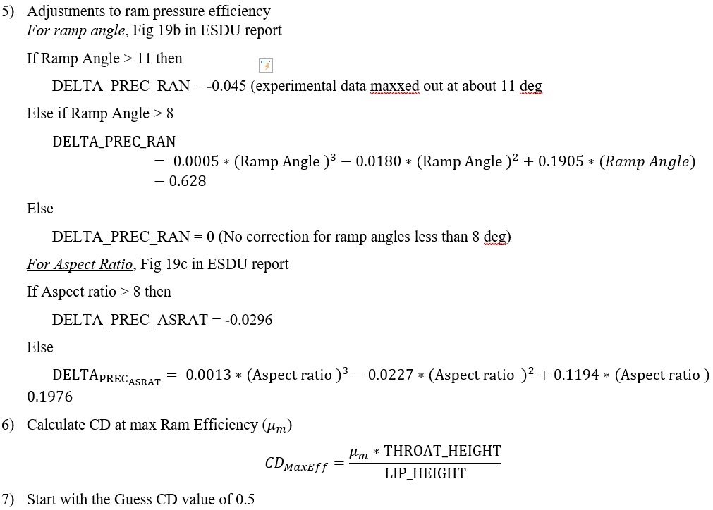

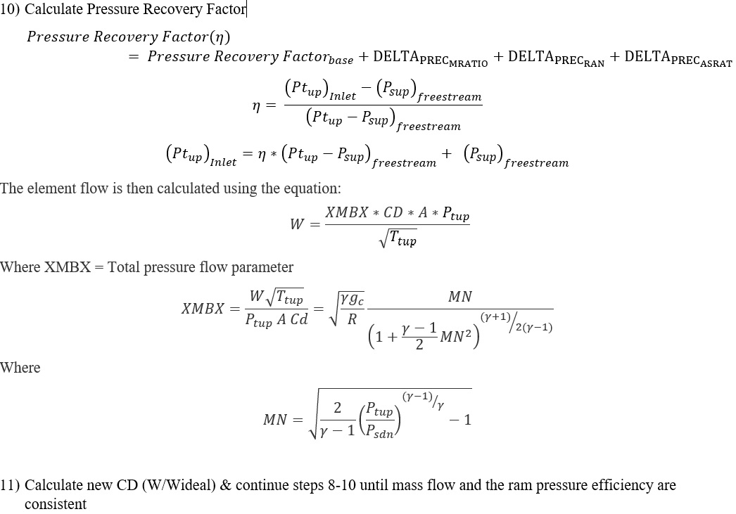

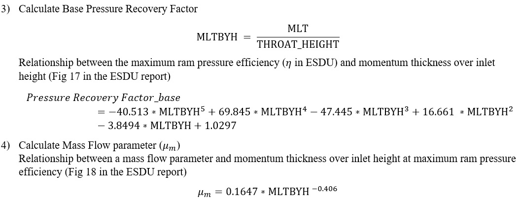

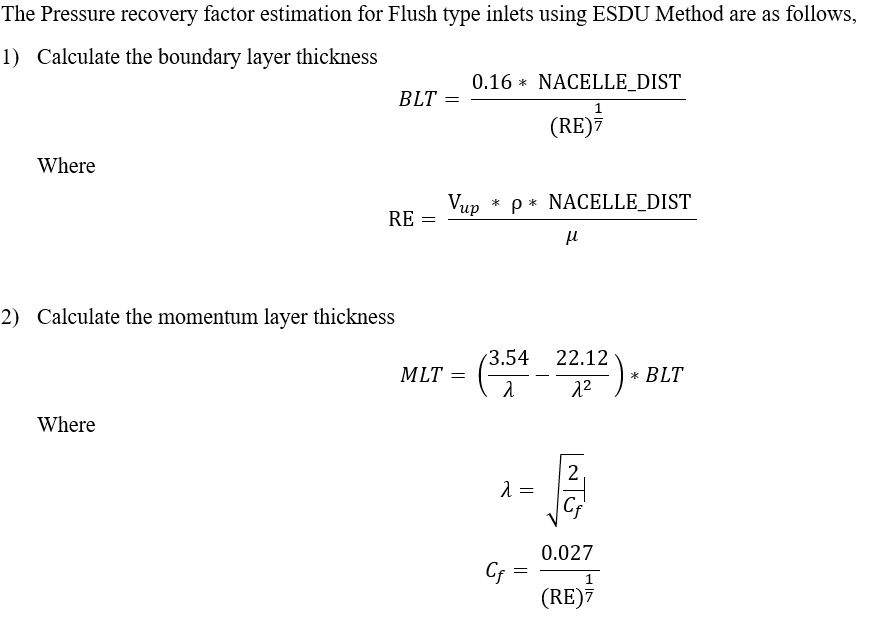

Flush Type Inlets (ESDU Method)

The following table listing contains output variables unique to the NACA Inlet Scoop (SUBTYPE=0).
Name | Description | Units |
NACELLE_DIST |
Distance from leading edge of the nacelle to the start of the Inlet. (Echo of the user input value.) |
in, m |
REY | Reynolds Number based on distance from the nacelle leading edge. | (unitless) |
BND_LAY_THK | Turbulent flat plate boundary layer thickness. | in, m |
P_RATIO | Pressure ratio (PT1 / PT0), (PTinlet / PTfreestream) | (unitless) |

The following table listing contains output variables unique to the ESDU Flush Scoop (SUBTYPE=2).
INLET_LIP_HEIGHT |
Flush lip height. (Echo of the user input value.) |
in, m |
NACELLE_DIST |
in, m |
MOM_LAY_THK | Turbulent flat plate momentum layer thickness. | in, m |
RAMP_ANGLE |
Ramp angle. (Echo of the user input value.) |
deg |
RAM_P_EFF | Ram Pressure Efficiency after adjustments (PT1-PS0)/(PT0-PS0), ETTA in ESDU paper. | (unitless) |
BASE_EFF | Ram Pressure Efficiency before adjustments (PT1-PS0)/(PT0-PS0). | (unitless) |
MFLO_COR | Delta Ram Pressure Efficiency due to the mass flow not equal to full mass flow. | (unitless) |
RAMP_ANG_COR | Delta Ram Pressure Efficiency due to the ramp angle. | (unitless) |
ASRAT_COR | Delta Ram Pressure Efficiency due to the aspect ratio. | (unitless) |
