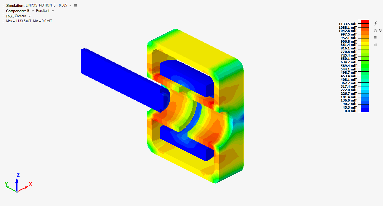

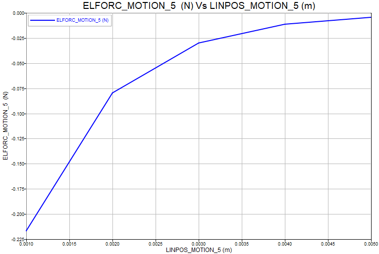

This a 3D magneto static solution.
Visualisation of magnetic flux density, magnetic field and force curve depending on the mobile part position.
