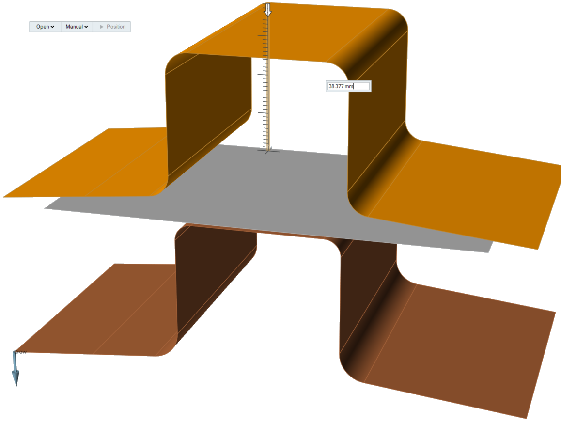

Note: If the tool has been positioned manually in the previous step, it will not appear highlighted unless you click to select it. The bottom die is stationary and cannot be selected for auto-positioning.Manual - On the model, select a tool to position.
- Select and drag the manipulator to move the tool to a new position. The manipulator indicates the distance from the selected tool relative to the bottom die.
- Alternatively, enter the distance in the microdialog.
Note:- To move the manipulator to a desired location on the selected part, press Ctrl and click on the location.
- The manipulator only moves parts along the draw direction except for the cam die which moves in its own direction.
- For the top, bottom, or cam pad, the measure tool measures the distance from the attached tool.
- When you move a top or cam die that includes a top or cam pad, respectively, the die set moves together.
Figure 1. Tool Positioning with Manipulator and MicrodialogClosed Position

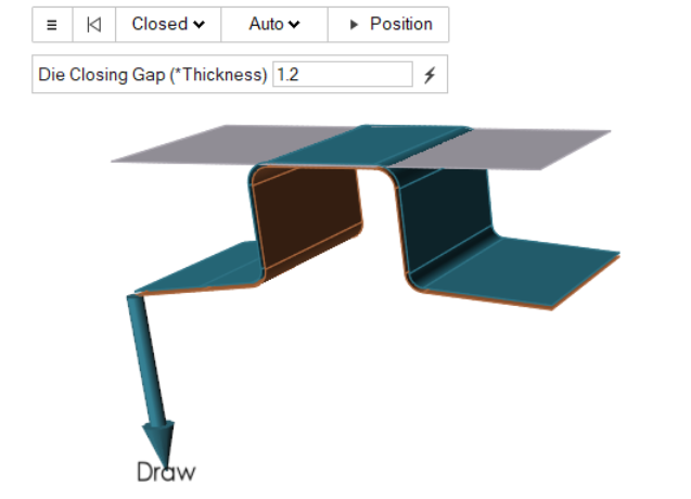

A guide bar opens with three fields. - In the first field, select a tool state for the die set: Open or Closed. Choose Closed to modify the die in the closed position.
Use the guide bar to configure the die. Click the
to
modify the Die Closing Gap (*Thickness). If you want to
return to Inspire Form's default settings for the tool gap, click on the
lightning bolt
