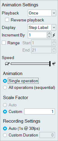

  4. Optional: To change the animation settings, click the settings button.
  5. Configure the animation settings as required:
    • Playback: Select whether to play the animation on a continuous Loop, Once, or Bounce (between forwards and backwards). Select the check box to Reverse Playback.
    • Display: Set the units for the slider Step Label, Time, or Frame. Step Label is the default and describes information about the current step, including distance to closed position.
    • Increment By: Increase the value in the counter to skip frames during playback. The reset button restores the default value of 1.
    • Range: Select to enter Start and End frames for the animation.
    • Speed: Drag the slider to change the speed of the animation. Drag to the right to increase speed and left to decrease it.
    • Animation: Choose between animating a single operation or animating all operations in sequence.
    • Scale Factor: Enter a custom value to change the scale of the animation. Generally the scale of a displacement is too small to see clearly, so auto scaling is enabled by default.
    • Recording Settings: The default Auto setting gives you an estimate of the duration of the recording at 30 frames per second. If your video plays back faster than you want, select Custom Duration to change the length of the video; this will adjust the frame rate to try to achieve the specified duration. The Custom Duration has a minimum value of 1 second, and maximum value of 30 seconds.
