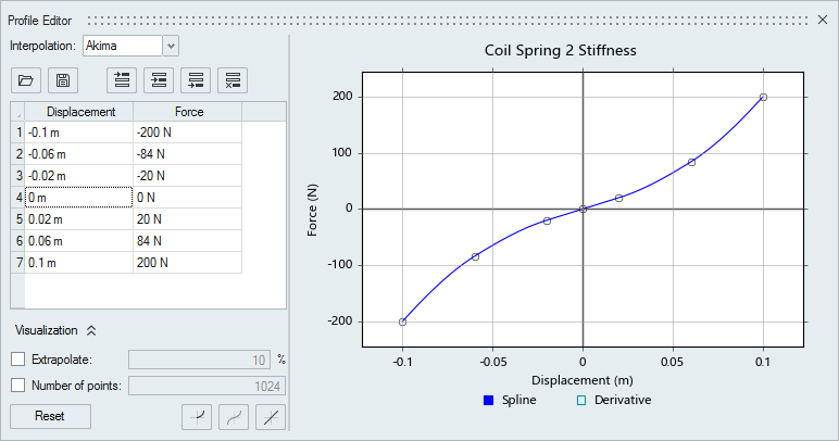

Nonlinear Spring Dampers
Nonlinear stiffness and damping characteristics can be entered for spring dampers for motion analysis.
- Sometimes it is easier to remove the left side data, work on the right side data, and then use the Reflect to Left Side button to reflect your data.
- Clicking the Replace with Linear Equivalent button will use the Stiffness value (shown greyed out on the microdialog) and display it as an editable curve in the graphical area of the Profile Editor.
- The Derivative button in the legend is helpful for the Akima and Cubic interpolation methods because it helps you visualize discontinuities in your data. Introducing more points may help you smooth the profile.
- The Provide Signals to Plant option is available for spring dampers in motion, but is disabled by default. It can be found in the Property Editor and when enabled, the motion Export operation will include the necessary plant signals in the .mdl file for use in MotionView, MotionSolve, and Altair Activate.
- See the Profile Editor for an explanation of the buttons and visualization options.

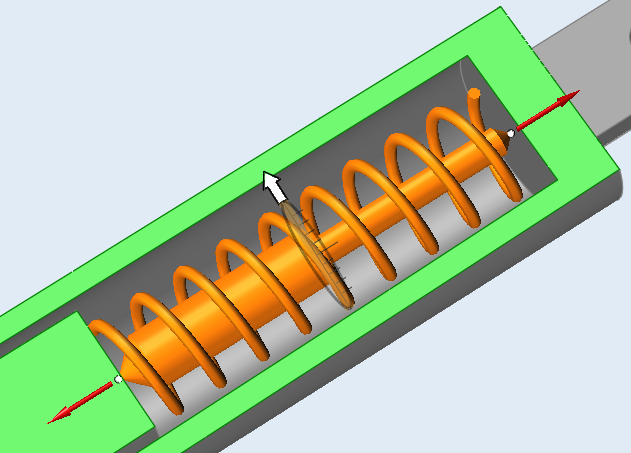

Double-click the spring to edit the spring's endpoints, diameter, and preload force.
Figure 2. Coil Spring Manipulator
- Endpoints
- Click-and-drag the endpoint manipulators to reposition the spring. You can move endpoints along a part, and it will snap to snap points, edges, and faces. You can also use the manipulator to drag an endpoint to a different part.
- Spring Diameter
- Click-and-drag the white arrow manipulator to change the diameter of the spring, or enter a
value in the microdialog. Click the chevron
to see additional options.
- Diameter: Change the diameter of the coils. Click the
icon to restore the
default dimensions of the coil spring. - Coils: Change the number of coils in the spring.
- Wire Diameter: Change the diameter of the wire.
- Preload Force
- Click the red arrow to change the direction of the preload force. This indicates whether the spring would expand or contract to reach its free length.

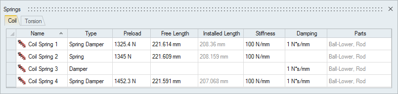

Springs Table
The Springs table lists all of the coil and torsion springs in your model and allows you to edit various attributes. Click the Coil tab to view coil springs.
Location: Springs tool, satellite icon ![]()
Figure 4. Springs Table
| To | Do this |
| Rename a spring | Select the cell in the table and then click again to make the field editable. |
| Change a value | Select the cell in the table and then click again to make the field editable. Some fields are for display only. |
| Sort a column | Click the column header. Click repeatedly to toggle between ascending and descending order. |
| Add or remove columns | Right-click on a column header. |
